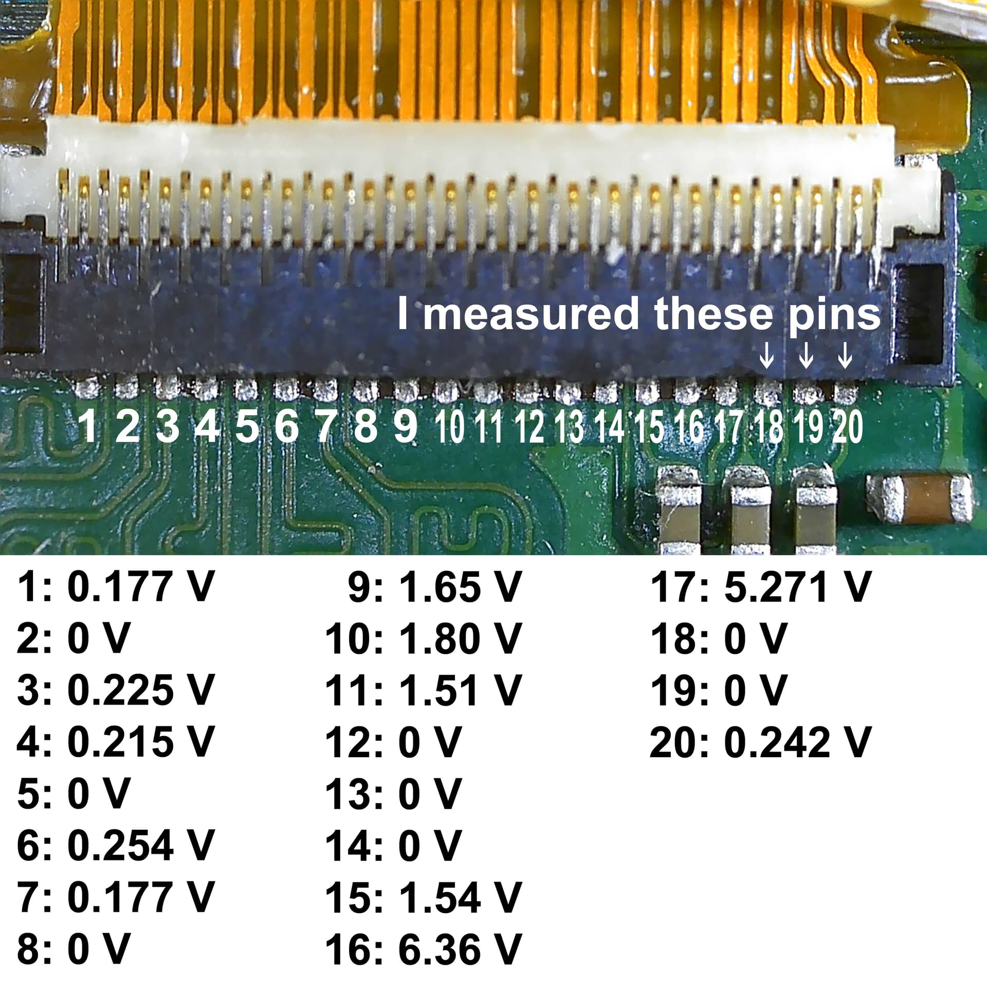

I did some measurements:

Hi. On the video connector, counting only the larger pins and from right to left, make sure you have around -5.4V (pin 8) and 5.4V (pin 10.)
Hi there, I am very sorry to answer so late, as I really did not notice that someone has answered to my question.
I am not 100% sure which pins you mean, but I will add a picture with all the voltages I measured on the shown pins.

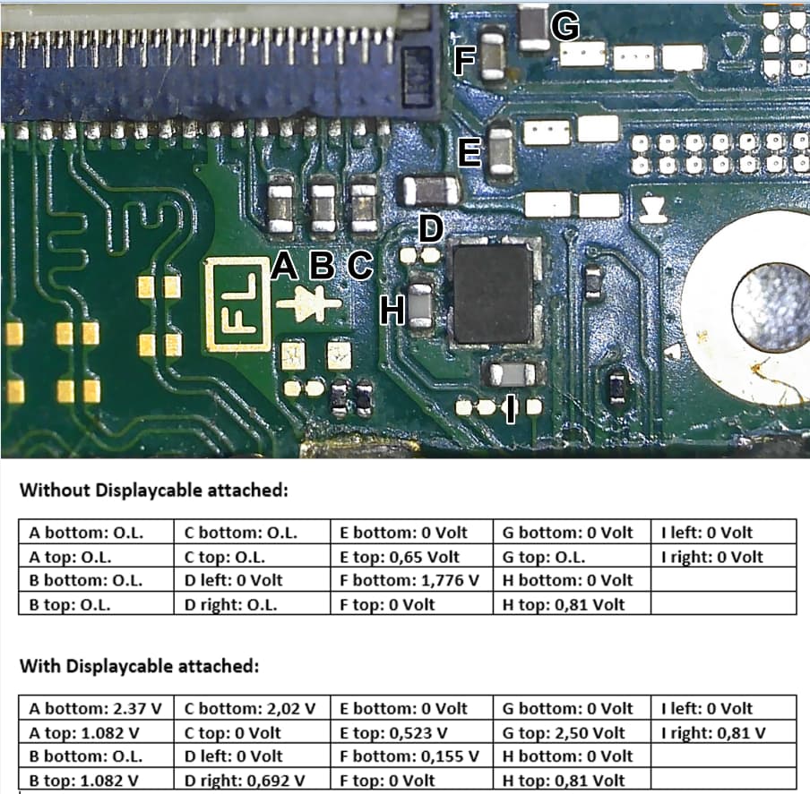

I still have that Switch Lite and it propably still has this issue. However, I got some magic smoke for whatever reason while trying to connect the daughter board, so I need to change its connector on the mainboard, the flex cable and I bought the lcd driver, which I still want to change aswell. If nothing helps, I can safely assume that my APU reball was faulty, so I would indeed redo the apu reballing and stuff.
