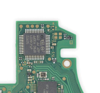

I have a Nintendo switch lite that does not have a working home button. Anyone know what could cause this? This is a water damaged Switch with a new daughter board and ribbon. That took care of it’s initially issues with the display. Everything else works but the home button. Thanks in advance for any info.
If I’m not mistaken, this controller is responsible for the buttons, take a look at it
