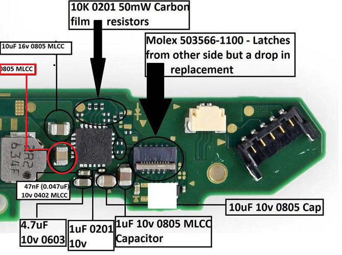

I lost capacitor/resistor near BQ24193 chip when i was trying to replace usb c port then that capcitor fell off. where can i buy this capacitor/resistor.
All the resistors and capacitors in that area are pretty standard, so you can get them from pretty much anywhere once you know the values you need.
There are some pictures around here that show the values, though I am on my phone so will see if I can find them later on.
Can i buy capictor 4.7uf 6.3v 0603 or do i have to buy 4.7uf 10v 0603
Actually No, From datasheet, it requires 10v cap where REGN line max is 7v from spec
Keep in mind that’s for the Regular Switch. The LITE’s BQ chip does not have a 0402 cap around it, instead those are x2 0201 caps with unknown capacitance or working voltage. I haven’t been able to find any info on those caps on the net, which is holding me back from purchasing the required components to fix a Switch Lite board. Also, the BQ24193 documentation seems to be for the regular Switch, not the Lite.
