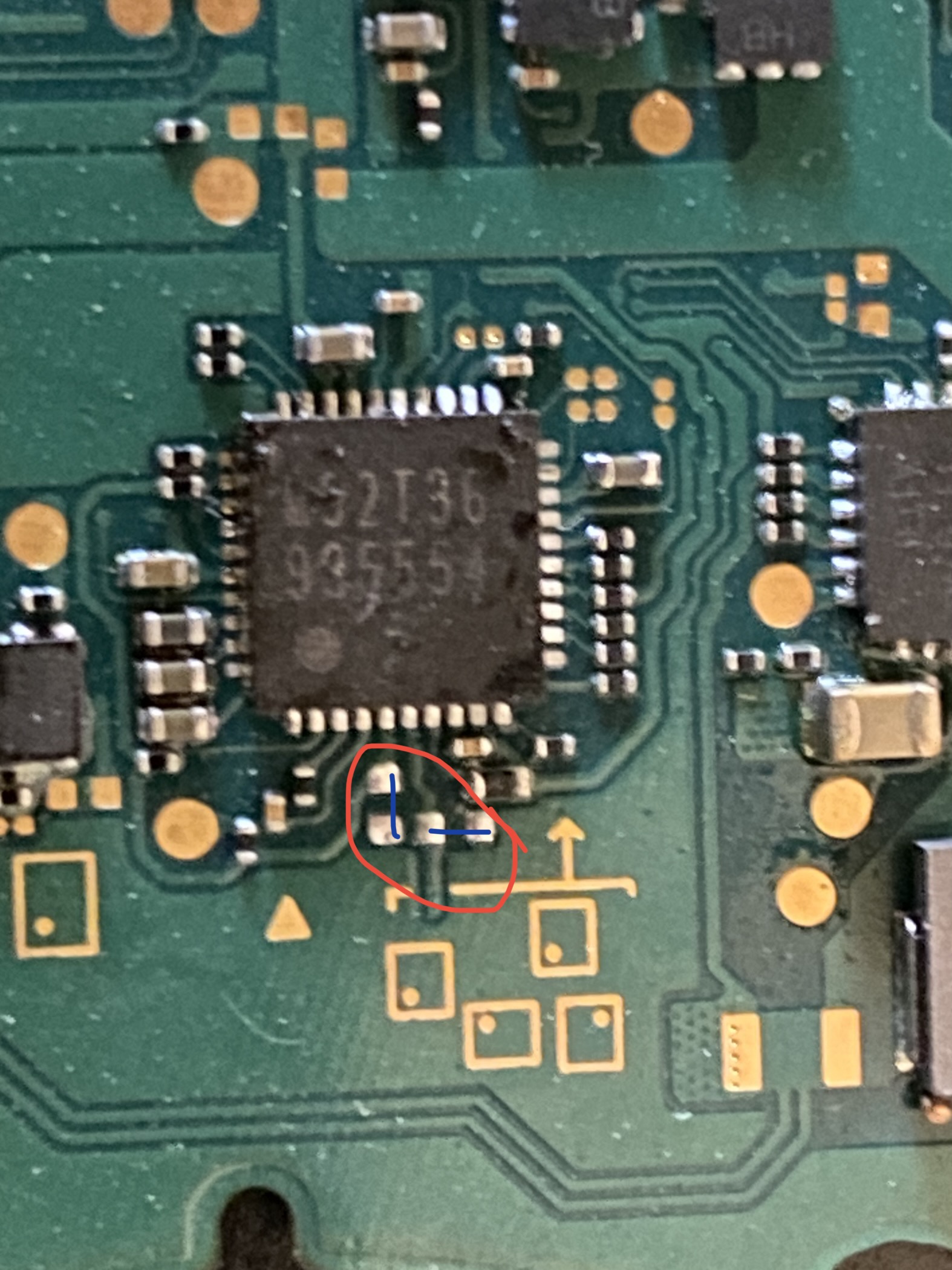

Hi, I was changing a I m92t36 chip and I accidentally knocked off two of the components and I was wondering if anyone knows where I can find them to purchase them they are marked in red. image|374x500
Should be same value from NS board

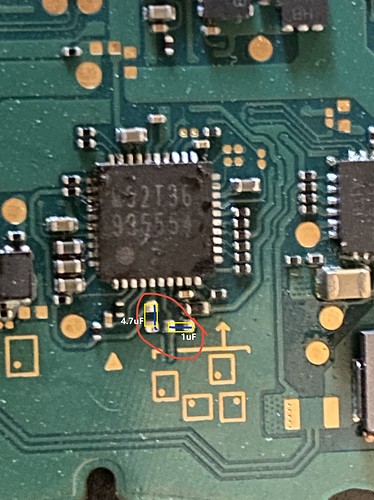

which is 4.7uF on pin5/ left vertical one
and 1uF on the horizontal one in your picture
Thank you so much do you know where I can purchase them
Mouser or Digikey if US/Canada
Do you know which one I should select because there is multiple ones
DOES NOT matter what brand you select, as long as they are in the same spec shown from the picture I upload.
4.7UF 10V X5R 0402
1UF 6.3V X5R 0402
Thank you so much for your help.

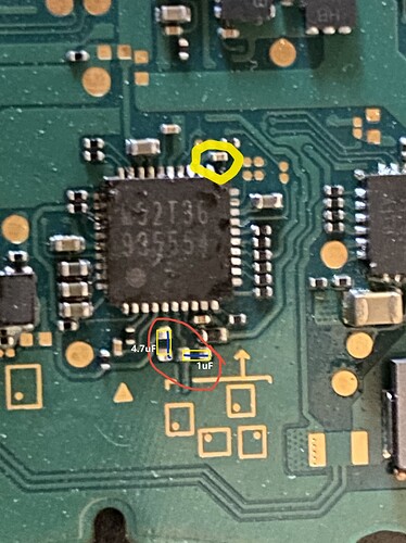

I know this is a old thread. Im trying to figure out the capacitor rating of the capacitor above the 6 on the chip in zoozoo’s picture.
I have no idea which where you talking about. upload the picture with highlight

THE one on top yellow circled should be the cap goes into S2_DRV_SRC (pin22) which should be a 10nF_0201 cap. I recommend using 20v~25v voltage rate
