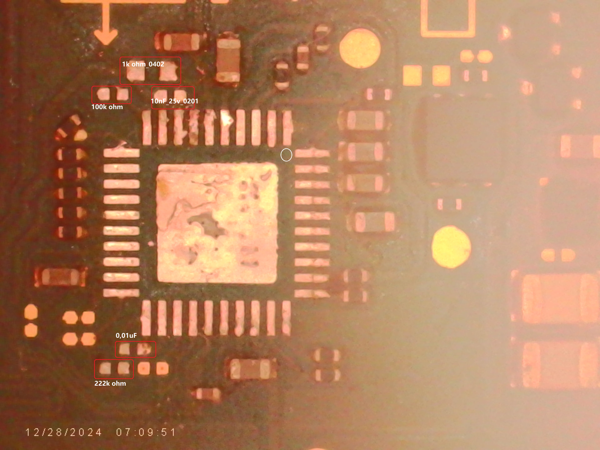

I need help identifying the values of which components I’m missing. I’ve tried to attach a picture or a link but it won’t let me.
Essentially it’s some of the little resistors / capacitors that sit around the m92 chip - i blew some away when i was trying to replace it. I know which ones I’m missing, but i dont know what they are!
Any help in ticking some off would be really helpful.

ibb dot co/LmS83fR
this should be all you need
Dude that’s amazing! Thank you so much.
