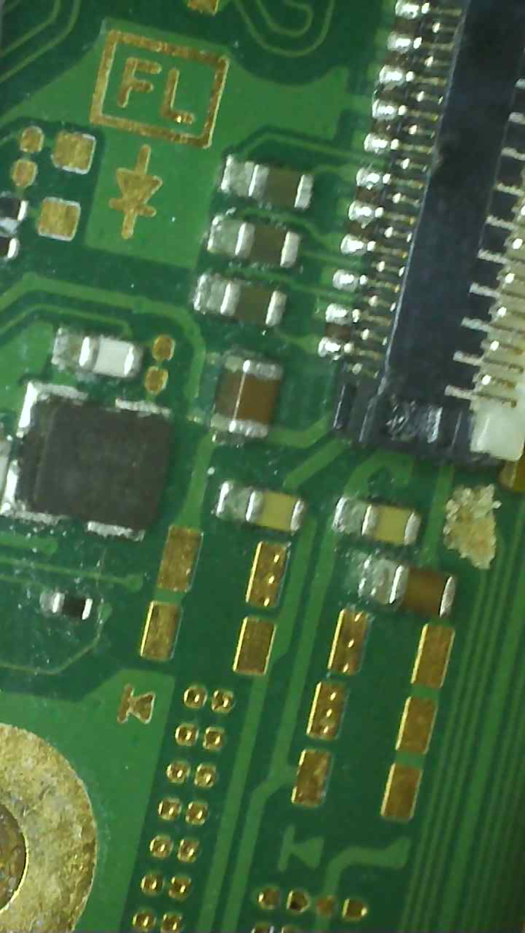

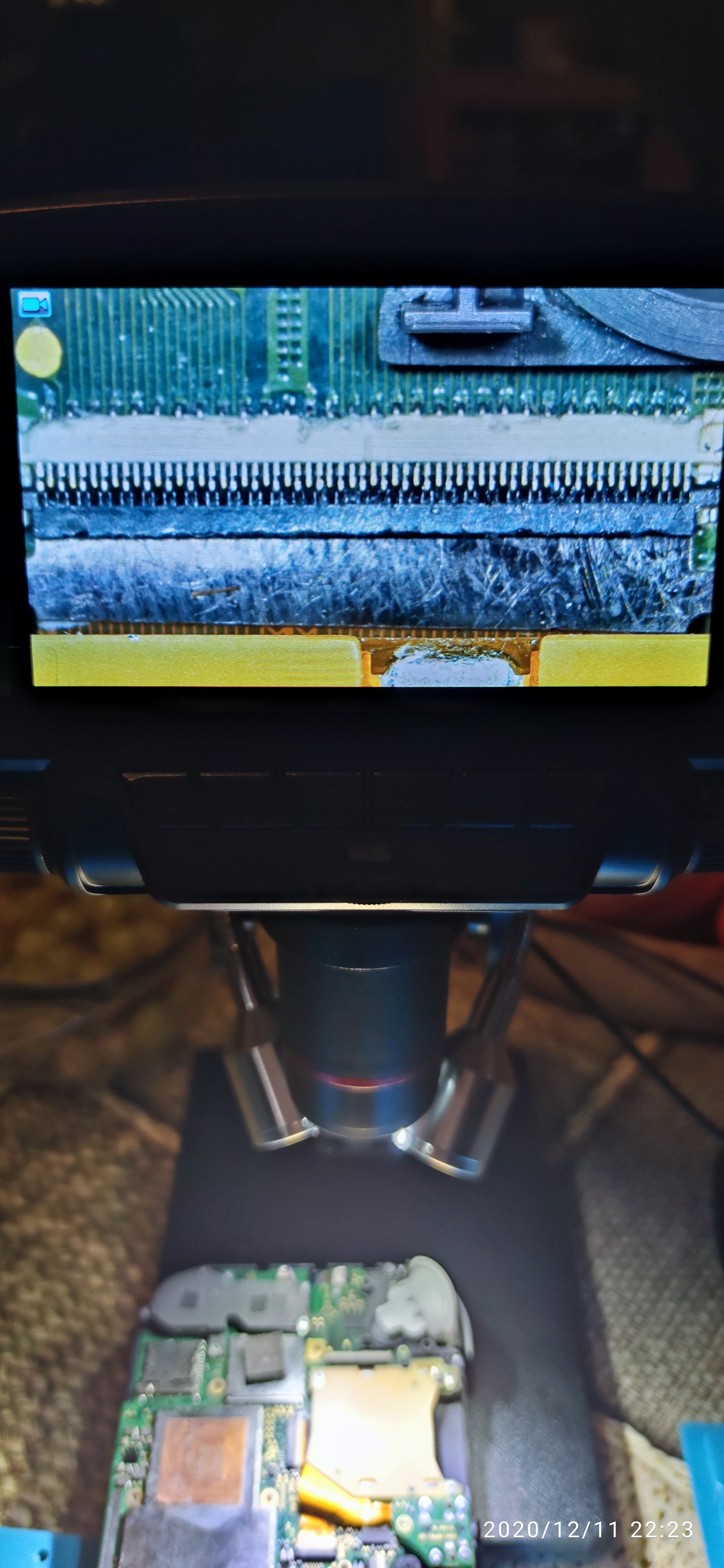

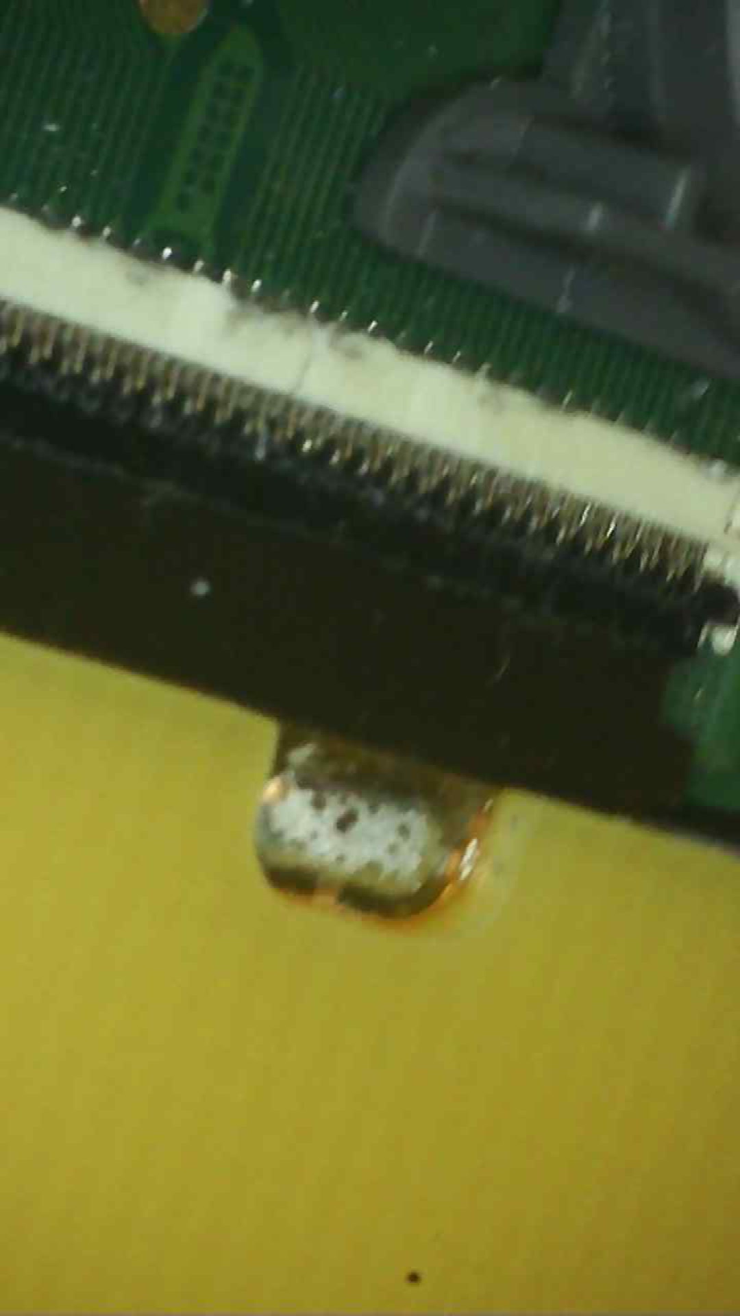

Upon opening I’ve discovered some sort of a jelly top of charging port shield. Port has been cleaned and I went with multimeter to find shorts. No shorts have been found. Nothing near the M92T36 or near BQ24198.

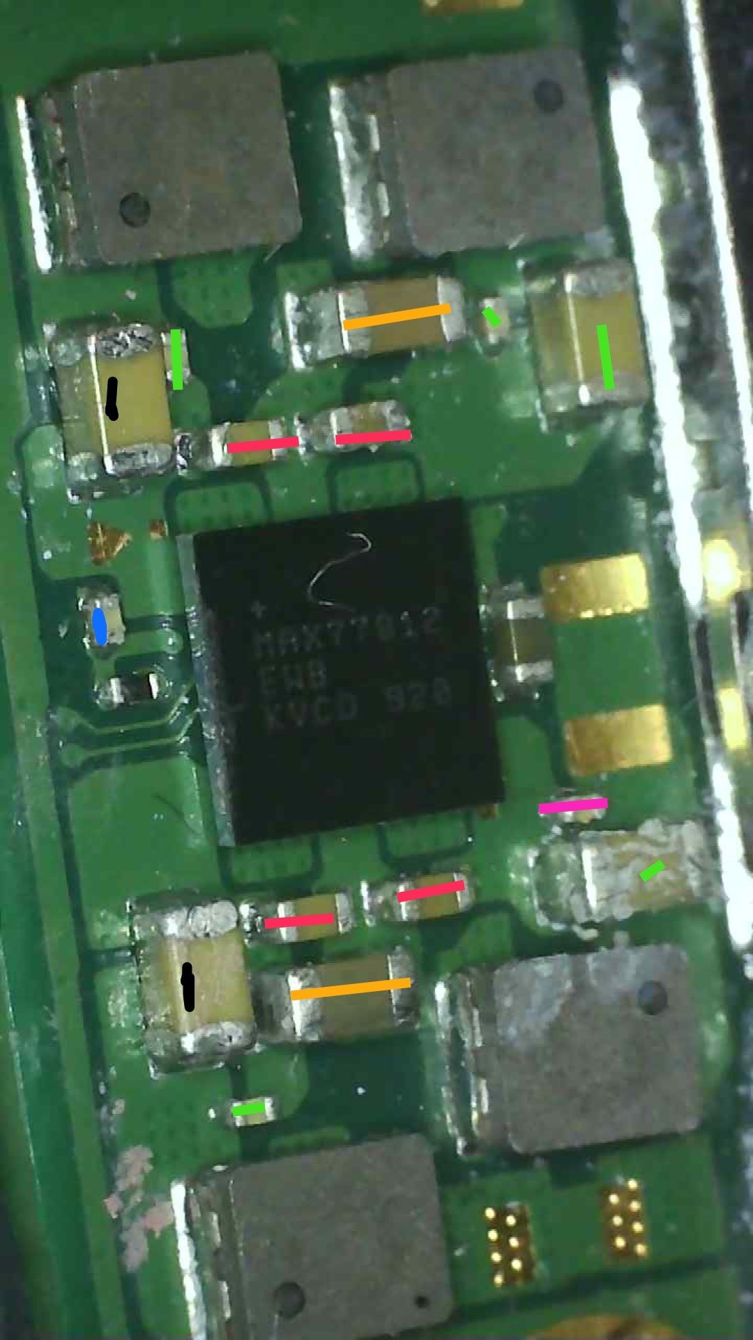

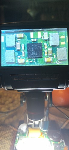

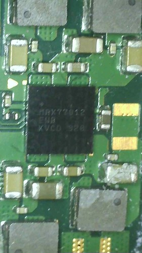

I am testing on 5V charger. On testing pads I’ve got 5V. Near M92T36 there is 5V present as well, pin 5 of M92T36 shows 5V, pin 6 however around 0.250V.
There was basically no shorts to the ground but the battery IC BQ24193 was faulty anyway. Changed it today for the new one and works perfectly fine again.
