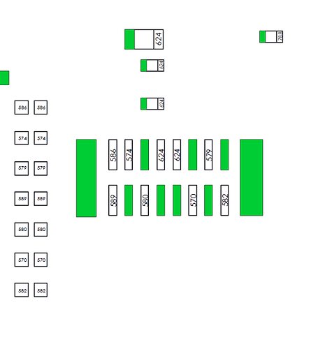

The values seems to be ok. Nothing jumps out like a ‘OL’ or ‘0V’.
Maybe your .615 is a bit off. But I don t know where this line goes from here.

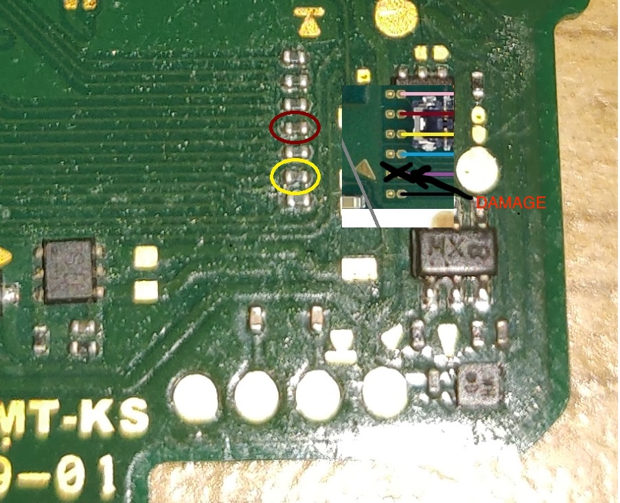

Hello, i was trying to solder pin from the microSD connector to the board, but i damage the piste in the board, on the image the color of the damage piste is purple , please help me,¿ in what
capacitor solder the jumper and in what side right or left ?,
and if I damage the capacitors, ¿what value have?, or where buy a replacement from the capacitors.
