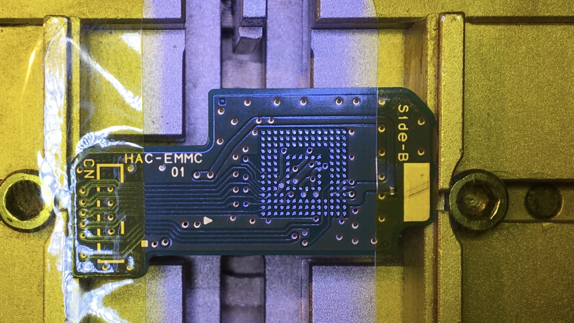

Until i get it, with hekate i have dumped eMMC BOOT0, BOOT1, eMMC RAW GPP, BIS, TSEC and SBK keys . I removed the eMMC board from the Switch and with the hot air station, i removed the original NAND chip and clean off the pads on the mini board. When the new chip arrives, they i come back with new information on how i progress with the work.

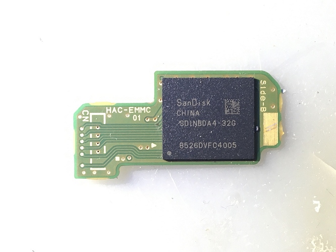

For me being the first time I try a nand upgrade, i first tested with a 32Gb SanDisk eMMC. Now that I have succeeded and everything is ok, i will order 128 GB.
