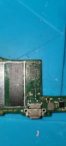

Nintendo Switch , NO POWER, already checked for M92T36, shorts under CPU

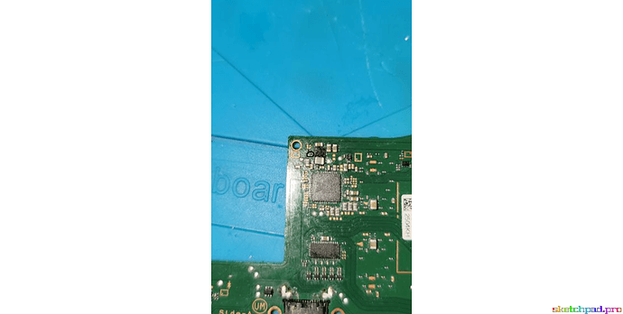

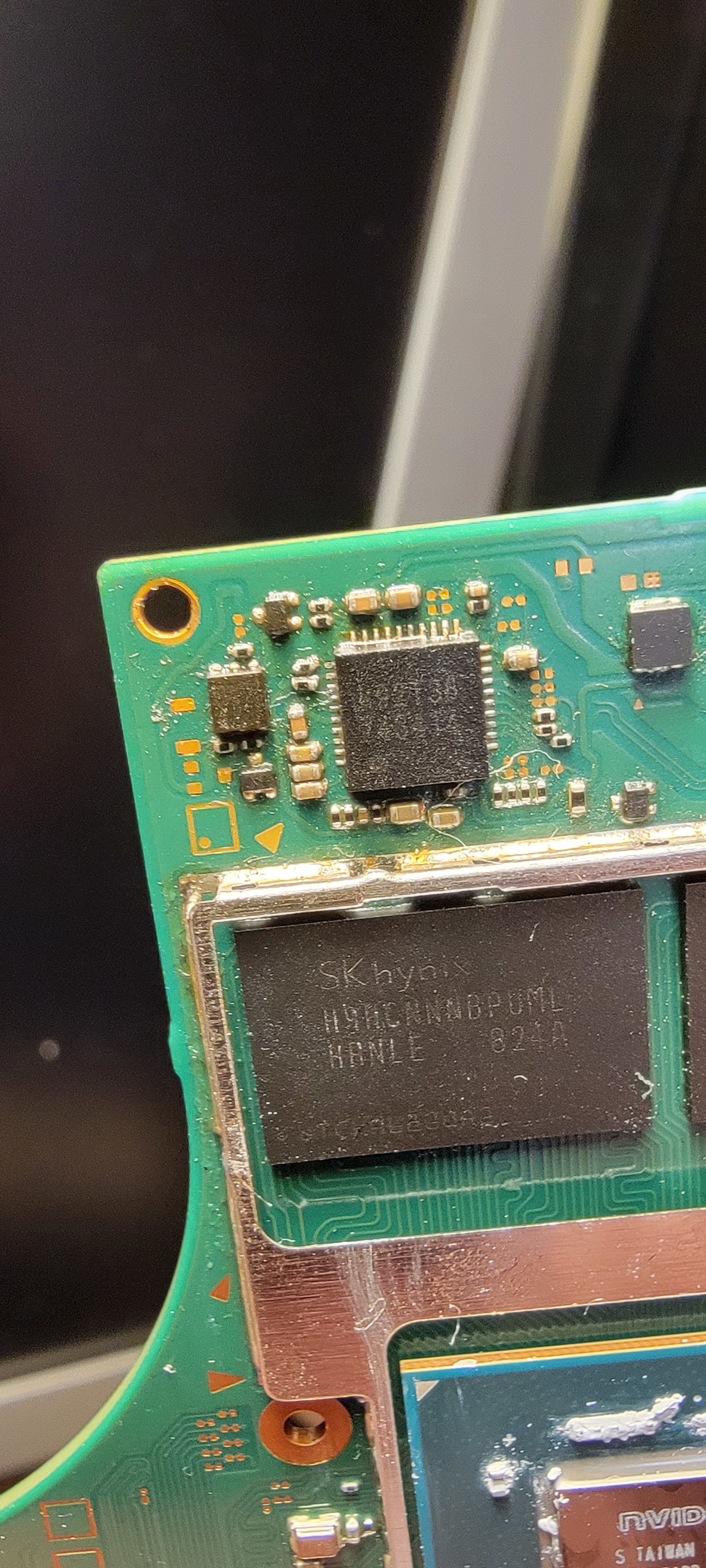

If the board is now spotless can you take some photos of your M92 IC install at various angles so we can check?
there is continuity
:frowning: i hope not, but im quite sure i’m screwed
of course here they are
These are photos of a day ago, cause i’m not home rn, i will come back though on sunday. Next week i will buy a new board, i’m pretty sure this is over and it has finished very badly :frowning:

When your back, submerge the board in IPA and scrub off all the flux with a toothbrush, your last few photos it’s still too caked I’m afraid, then try to show us the pins around all sides of the M92 and BQ IC.

@Severence Hi there, still 0.00amps, i should also mention that i lost a little component when i replaced the m92t36 which may or may not be important. Below there is the photo of the M92 chip, and the little component that i replaced with a resistor
Photo of the component
i just noticed that there might be a bridge on the 3 vertical caps above the M92, trying to fix it now
nope, removed the bridge still 0.00

Also, if you can take a few photos of the M92 pins round the edge of the IC so we can inspect and same with the BQ IC.
