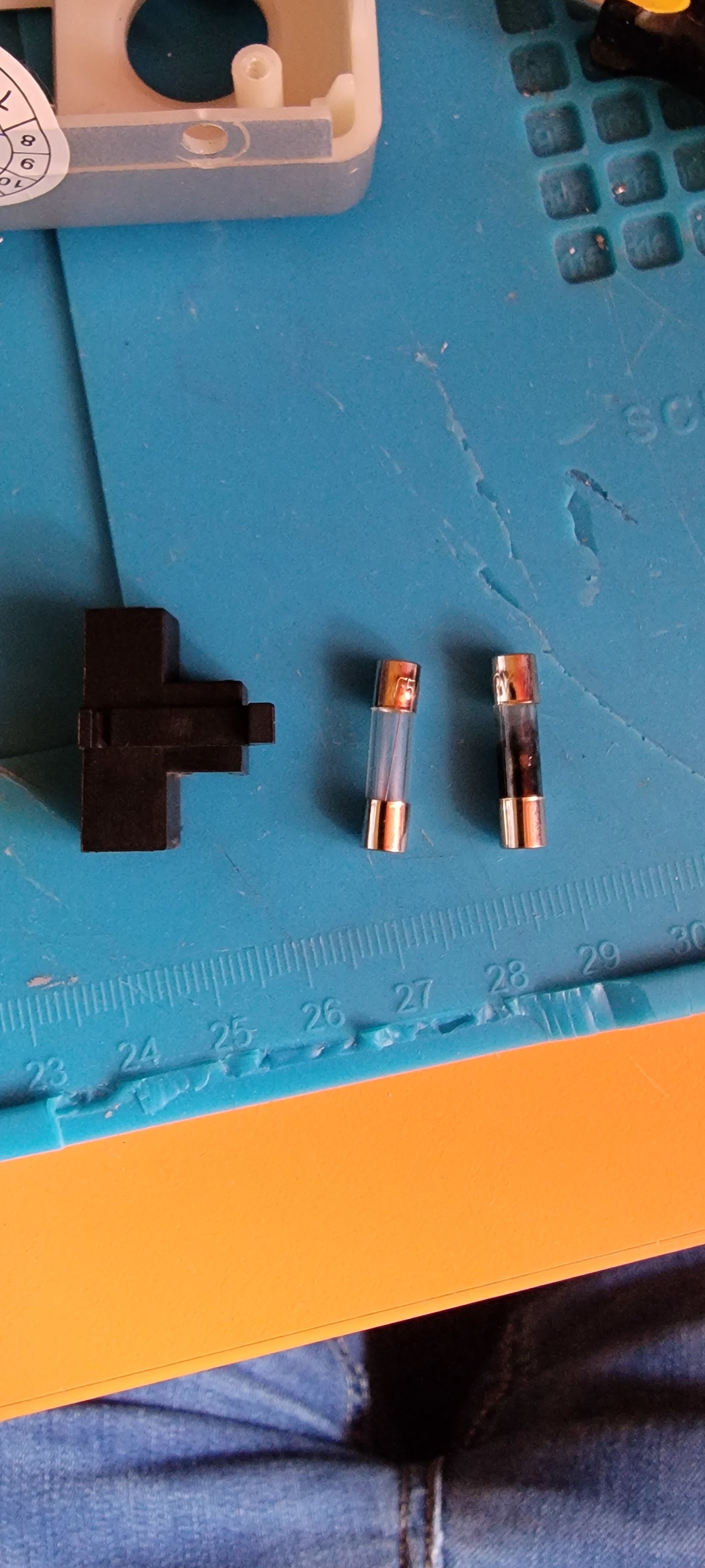

Wow. What a lucky moment. only the fuse blew up and there was on that little black box another one for replacement.

Future reference, fuses very rarely fail for no good reason, in almost all cases there is an underlying fault which should be found and resolved prior to installing a new fuse and powering on… Hopefully the gun isn’t now shot too as a result :frowning:
already thrown the heat gun in the bin
