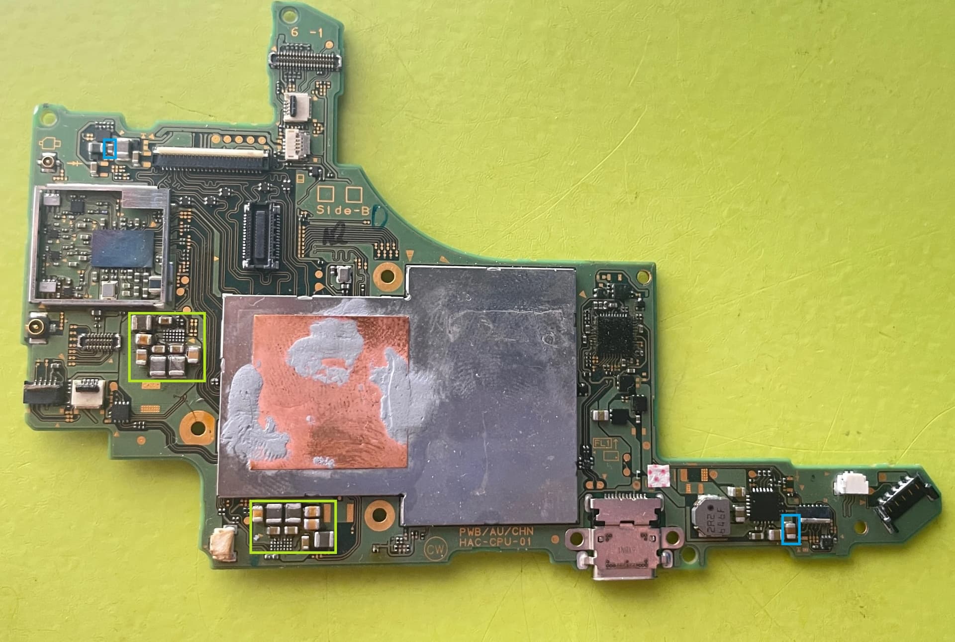

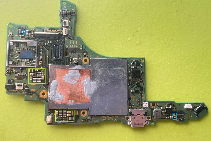

Hello, first post here and first time fixing a Switch. I recently got a Switch that won’t turn on and doesn’t seem to charge. I looked for short circuits and I found a lot around both of the MAX77621 so I removed them from the board, but the shorts are still there. I kept looking for more shorts and there were a lot.
I still can’t upload images so I’ll do my best to explain what capacitors are the faulty ones (considering that the USB port is placed on the bottom for every reference):
From the front of the MB:
Almost every capacitor around the MAX77621 chips
A capacitor around the BQ24193, the closest one to the rigth joycon connector that is placed vertically
A very small capacitor from the top left of the board, the one to the left of the biggest capacitor of that area

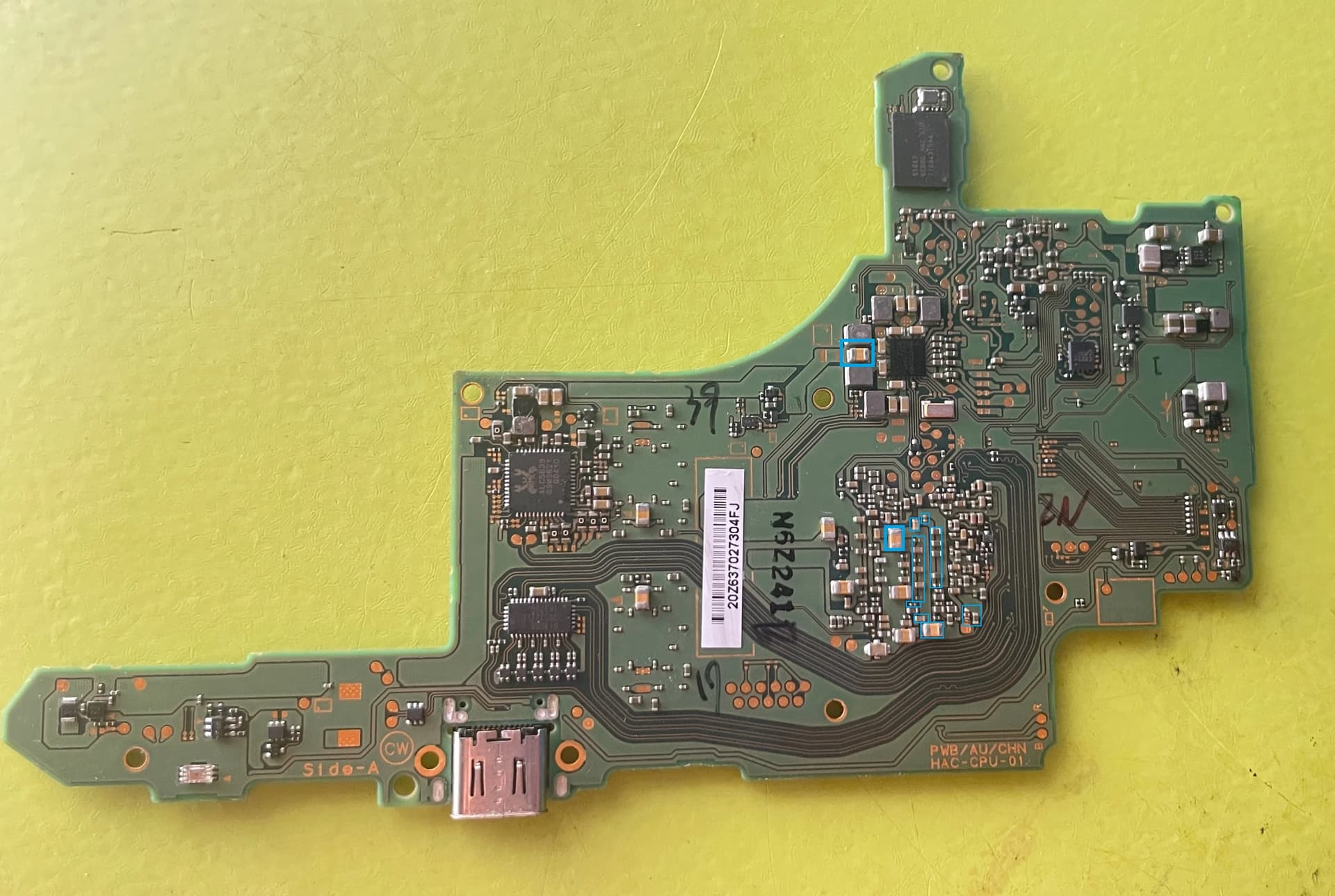

From the back of the MB:
Around the MAX77620, the capacitor on the left side that is the closest to the square with an arrow drawn in the board
Behind the processor there are a lot of capacitors. The faulty ones are: one in the middle that is placed vertically and two whole columns of horizontally placed capacitors that are very small and are just to the right of the other capacitor.

I added photos to a post named “Switch not charging & not power on” to another forum called “gbatemp”. I can’t add links either… (sorry) but if you want to find the photos, they are uploaded there and I hope it’s easy to find.
HERE is your pic from another forum, help you repost here for easier understanding
