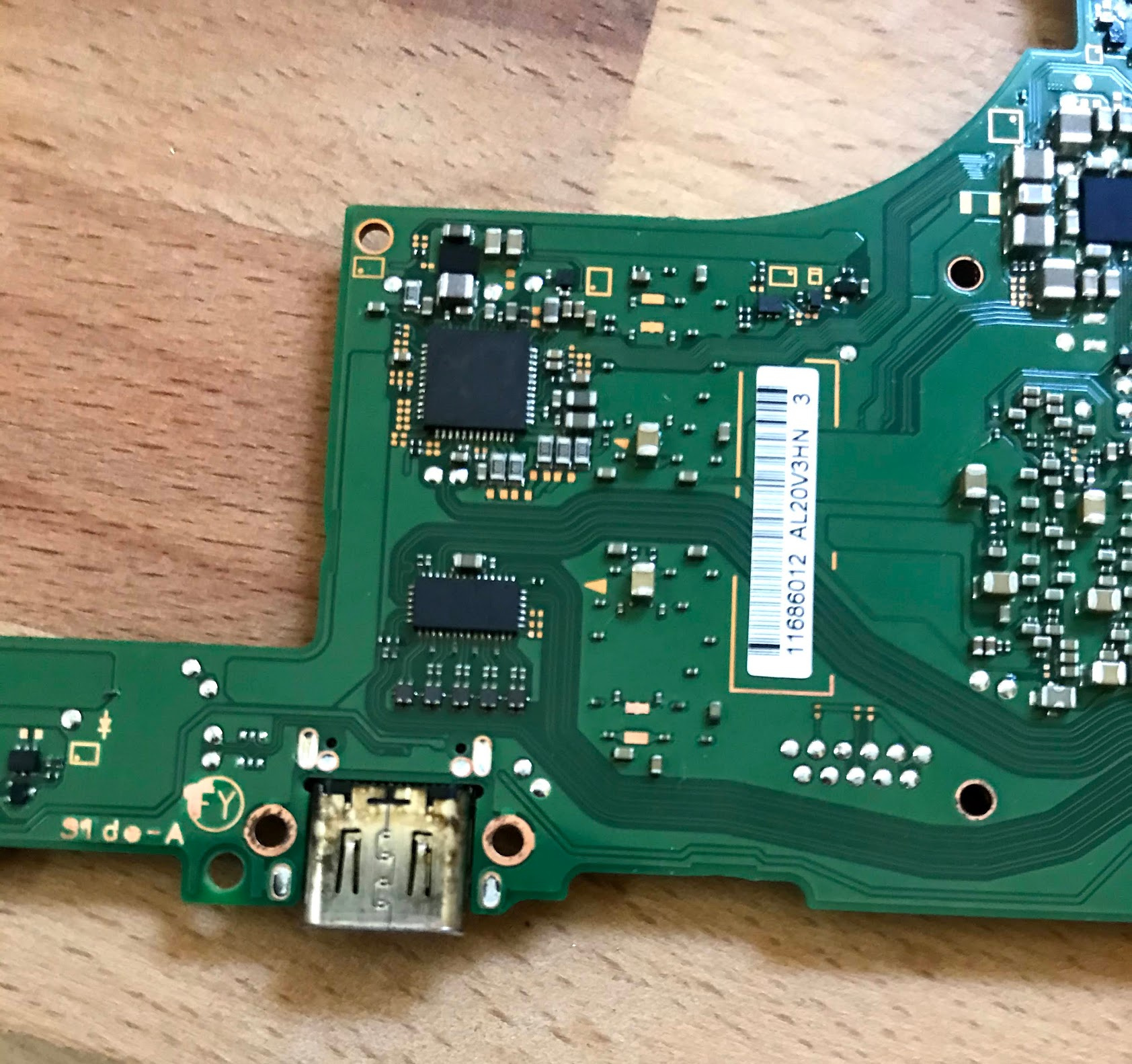

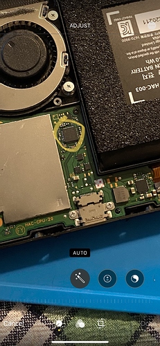

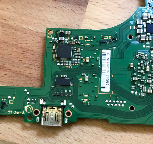

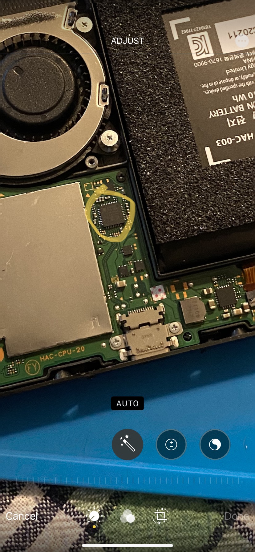

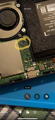

Update: I took the entire thing apart and cleaned it. I plugged everything back into the motherboard and the problem persists. The charge port is burnt on the bottom so I will be replacing that. When it is plugged in the Switch shows an icon in the top left corner of the screen with a green battery. I left it charging over night before I took it apart and the battery was almost at full when I unplugged it an replugged it in in the morning. When the volume and power buttons are held while the device is plugged in the Nintendo logo will briefly appear on the screen. Here are some pictures of everything:
Altough the chip is not shorted doesn’t mean it’s working properly, only way to find it out is by replacing them…
That’s so annoying and they are expensive- is that the only chip that could be causing the problem?
it’s a 10-15 dlls chip… i think it’s pretty cheap if you compare to the cost of a new switch… another option is taking your switch to a repair shop… where are you located?
