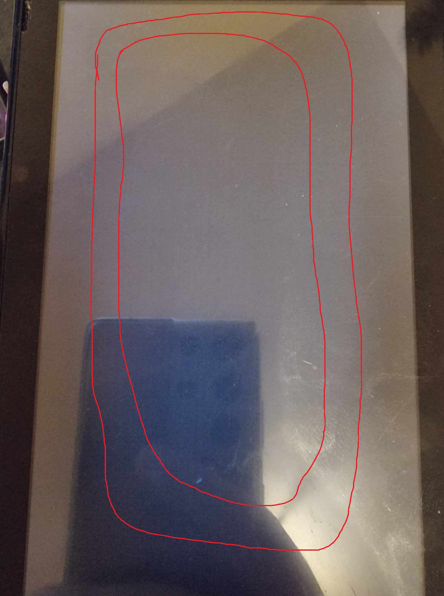

Update. So almoust 2 days in. Been testing the console letting it run games afk ,sit in menus etc. All seems good until today. i left it afk in heckate, turned it off. When turned on it gave me a blurry screen, the outline in the picture was filled with white light.
Then the whitelight faded and went to a blackscreen (backlight on). The console was on and running, i think it was a problem of display . This is not the final display of this console,only a test display. Ill check it more with the final display i guess to narrow it down. But would save me some time if anyone could confirm or deny.
