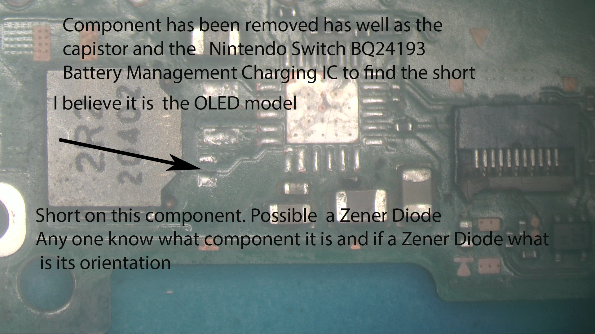

Nintendo Switch with a short on a companent (It may be a Zener Diode)
Does anyone know what the part is and if an Zener Diode what is its orientation
Please see image with the details
I really appreciate any input with this issue
Thank you
its a diode with a 8c marking on it. the line faces the bottom of the board. Also that picture is more than likely from a v2 board, but definitely not a OLED board.
thank you but the problem is that it seems no one knows the part. I am told the switch will work without it, The way see it that part was put there for some reason So it would be great to find out what the part is. - Thanks
Thanks for the 8C marking. so I did a search of it and i found a few thing.

I not think that will help. It is just a marking for it and there are many other devives with the marking Its a pity its not on it
This is the reason they do not put the name on it
This if from my search
Due to the small size of most SMD components, manufacturers are not able to write the full part number on the case. They use instead a marking code typically composed of a combination of 2 or 3 letters or digits. When repairing an unknown electronic board, it becomes so difficult to know what is the exact type of a given component. This database allows to quickly find the part number of a SMD component when you have only the marking code.
Looking at the database of the code 8c rgerte are many zener diodes shown Hence how do tyou get the part from its code if there are so many with the same code

It is a Schottky diode. Not sure of its values but I was able to order them off of AliExpress. Haven’t looked anywhere else for them.
