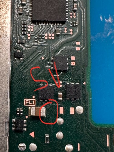

I have fix MT92

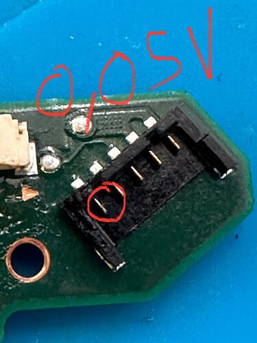

Now switch boot and work but when I connect usb cable ac 5v for charge I get 5v but only 0,005 on battery pin
And switch have logo charge but don’t charge
Do you idea ? Thanks

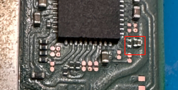

seems you have these couple mate shift to wrong position.
Good one should look like this.
Omg fucking work now , thanks you so much ![]()
