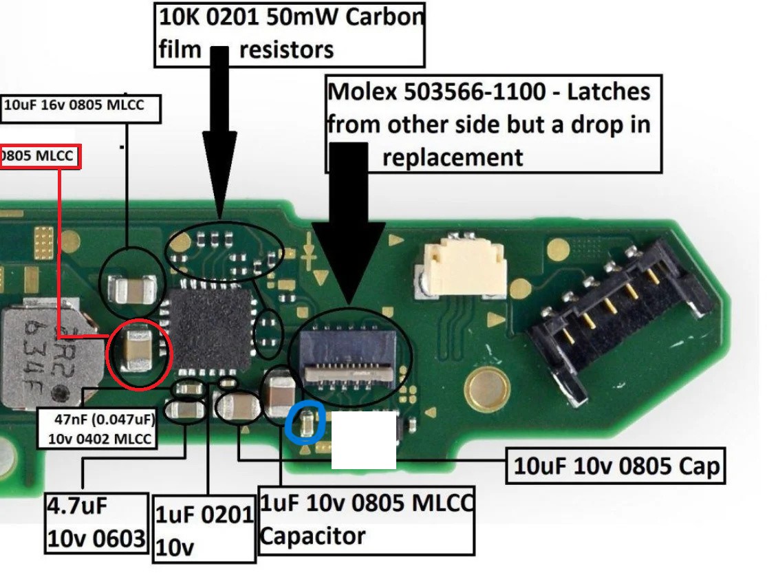

Nintendo V2 Board. Capacitor value near BQ
Hi I’m working on a Nintendo switch V2 board and while soldering the BQ chip I lost a few capacitors
I found a photo online with the values of most of the caps i lost but there’s one I’m still missing and don’t know the value of
The one circled in blue in the photo is the one i need the value
Its a 1uF 6.3v cap there
