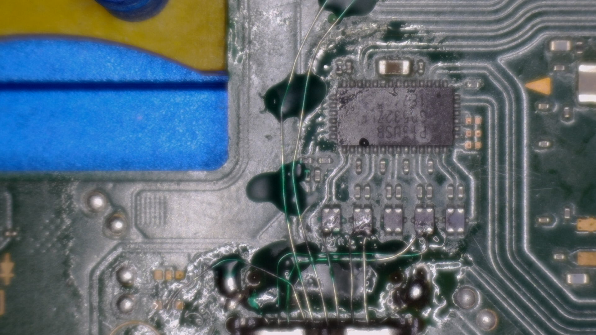

After USB broken port, I have no image in dock mode.
Also, it seems the console only charges with official charger, does not charges at 5V.
Top pads of USB port are nice and solid.
Bottom pads was all ripped, I tested all my work with this test board, every diode values are correct, and I have no short.
I test P13USB and have all correct values in diode mode, even every filters are correct.
I’m a little lost, any help appreciated.
