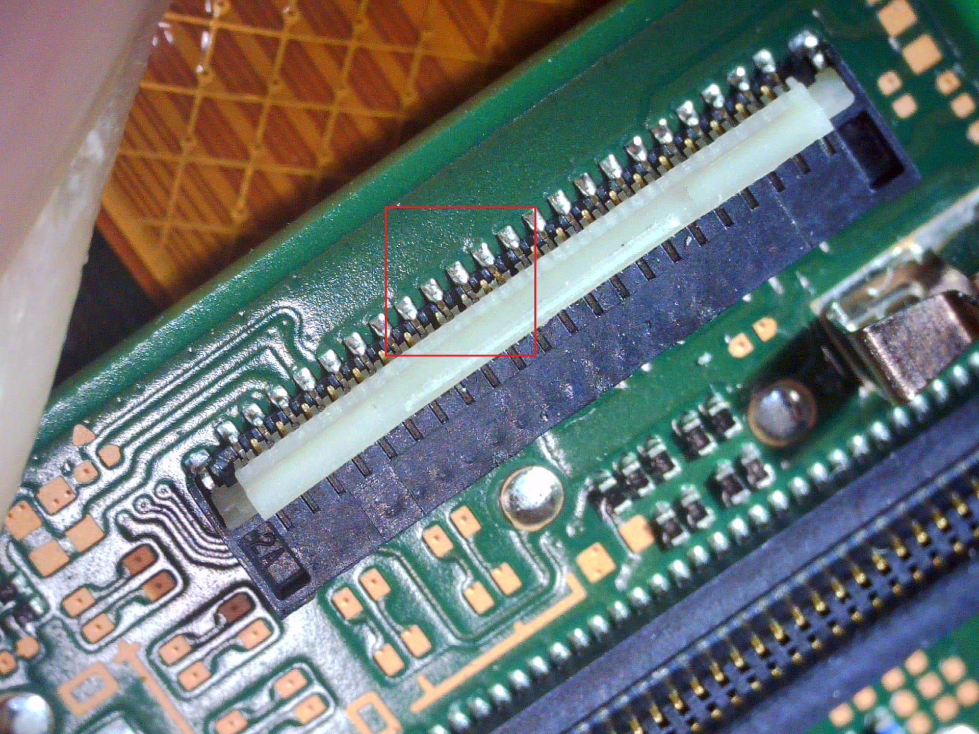

I have been inspecting visually the traces around D point to check noting is scrapped and I can’t see nothing really out of place.
I was wondering if anyone could help me diagnose what is happening, maybe some measures to take or check, I’m not really an expert in this console.
Thank you very much.
Just checked more closely today and confirmed the suspicion I had, the FPC connector. I think is the first think you have to look, those are pretty delicate.
