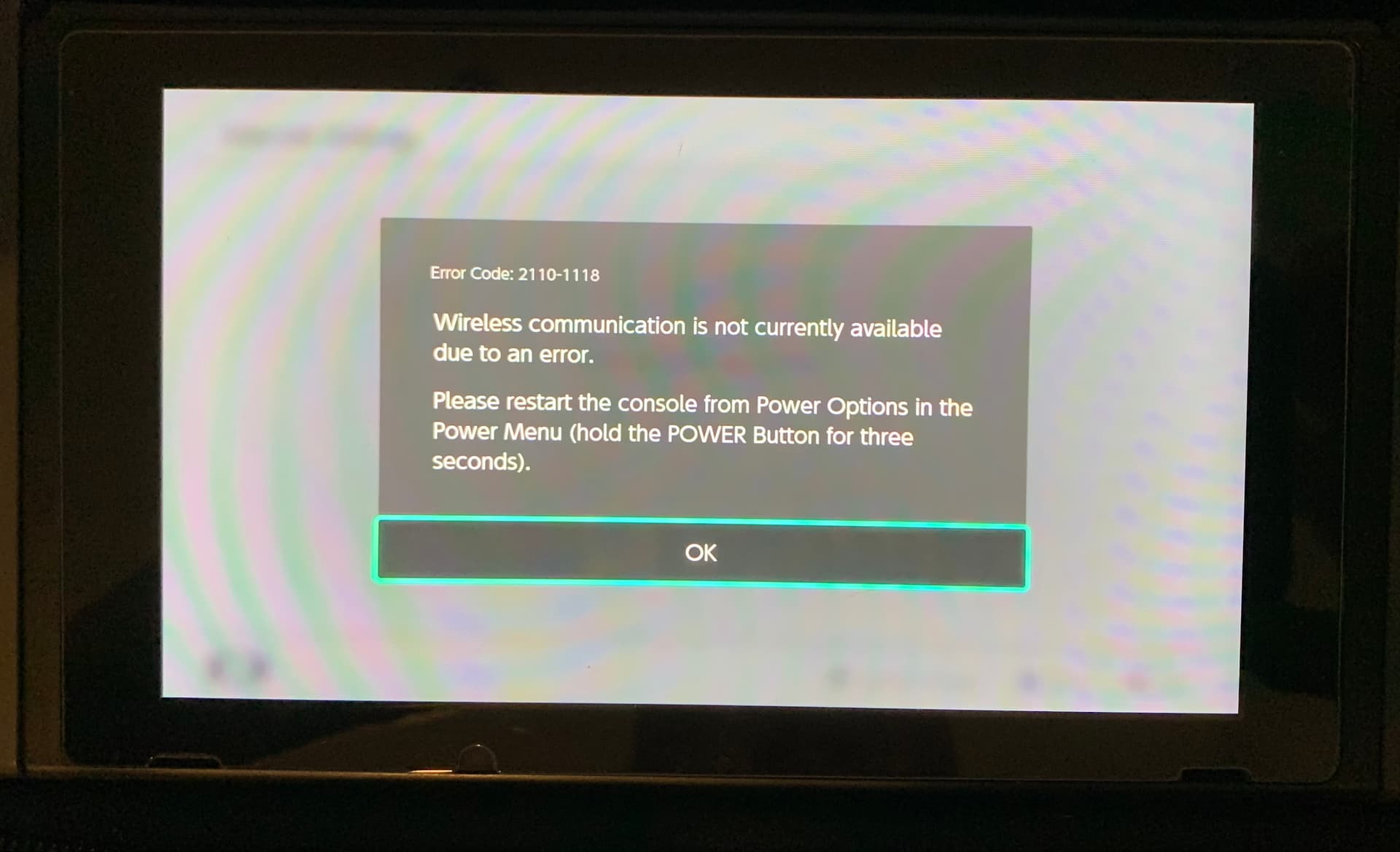

No wifi on Switch V2 after HWFLY install Error 2110-1118
I made several installs of HWFLY on V2 and Oled and it is the second time i have no wifi on a modded switch V2
Error 2110-1118
The bluetooth is working though.
