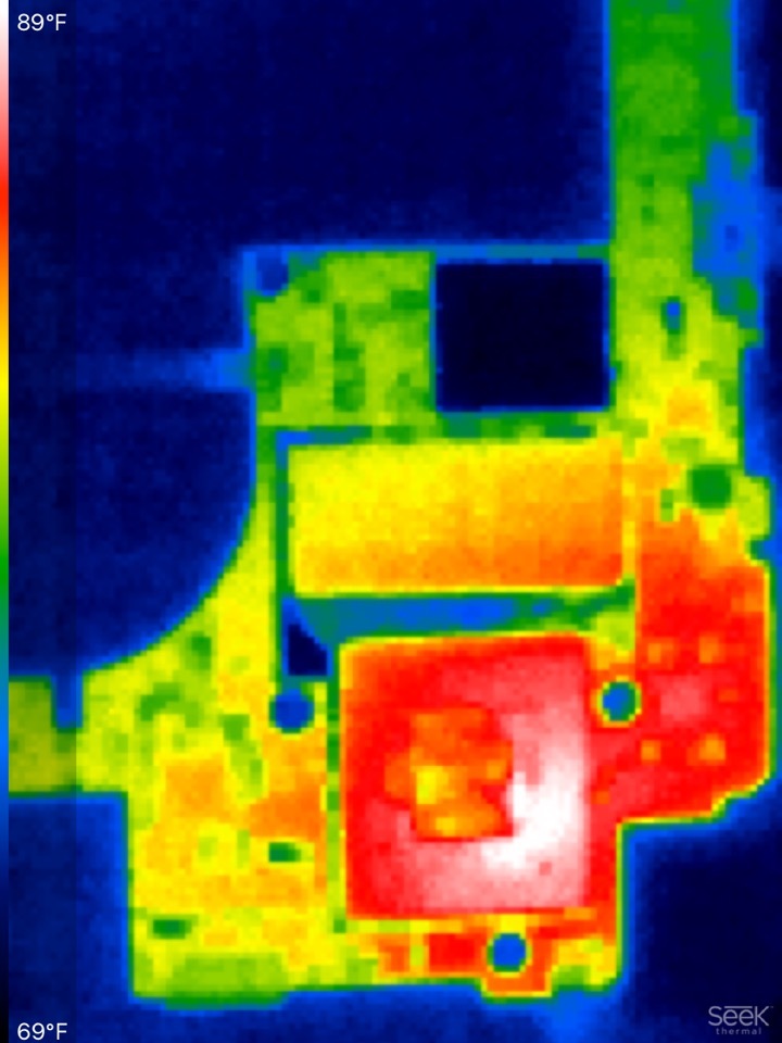

Hello, I have a switch oled thag is currently not displaying or charging. I personally couldnt find any fuses that were out and i have replaced the fuel gauge ic and the buck regulator.
At this point, im thinking aboht the usb c chsrgj g chip, or the battery charging ic. I have already replaced the port.

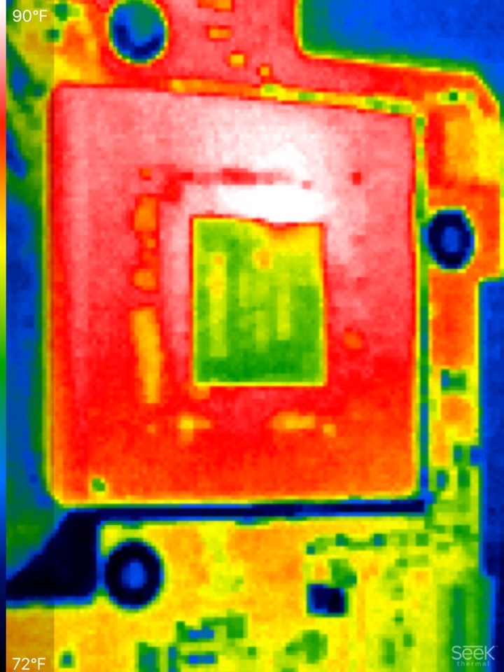

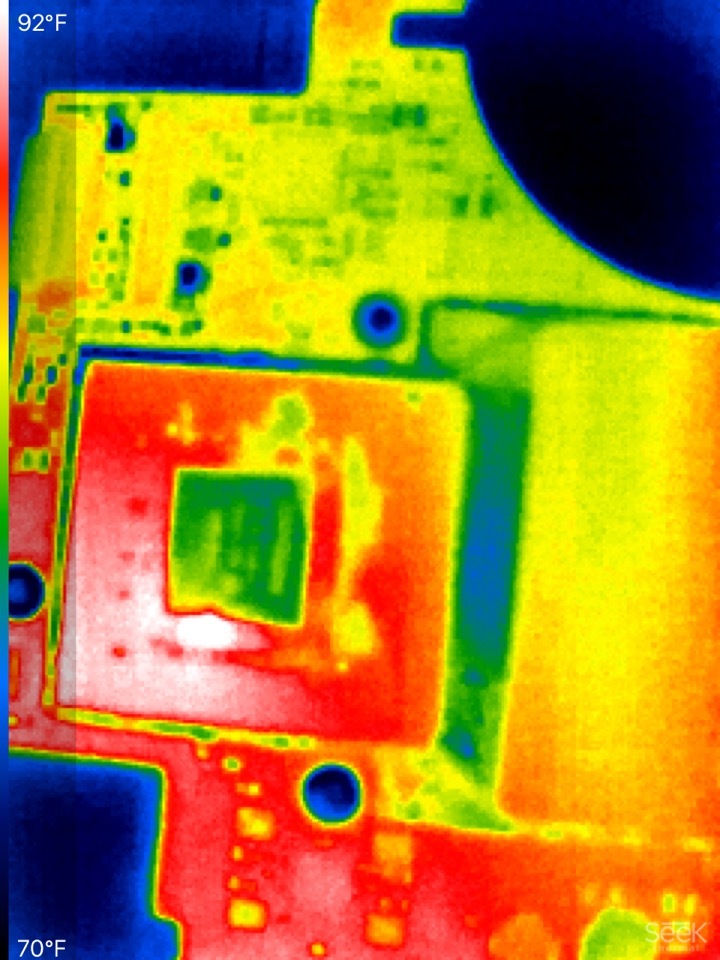

When the battery is plugged in, the switch does start to get warm as if its fully booted and running normally. Cant find anything that is screaming shorted.
Does it get hot like that without press power button to turn on?
Please provide voltage reading around max77812 and max77620H
Yes, when battery is plugged in it warms up too that, but not higher.
If you could, can you send a picture of where i need to measure the voltage?
