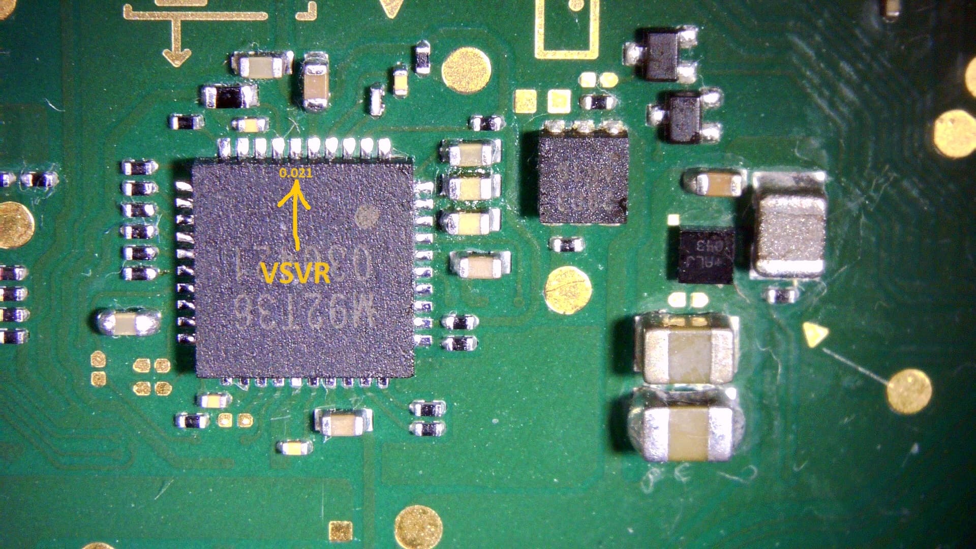

I have a issue on a Switch Lite I try to fix.
I already changed the USB C connector, the BQ and the M92T36.
When I plug the 15V charger, I have 15V and 0,085A (+/-) on the USB adapter.
I do not have any short on the board.
The only issue I am able to identify is a weird diode mode measurement on the VSVR of the M92T36, with 0.021V (I should find 0,390V, also verified on a known good motherboard).
With the charger plugged, the VSVR ouput is 3.28V.
I am stuck, someone with an idea?
