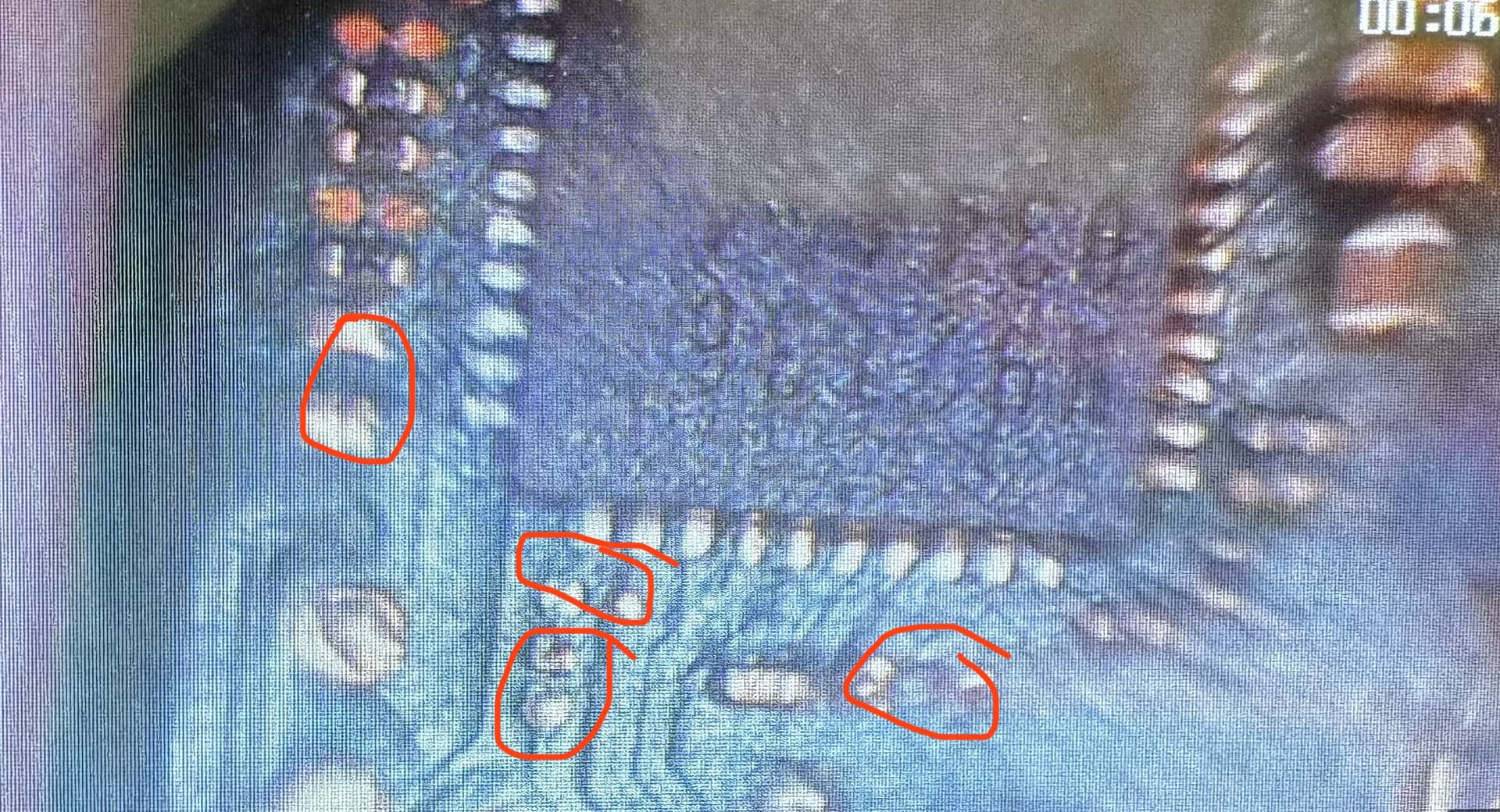

knocked out a few capacitors and ended losing them just cause newbie
i provided a photo if anybody can either provide type or links i would appreciate it and to identify where they go

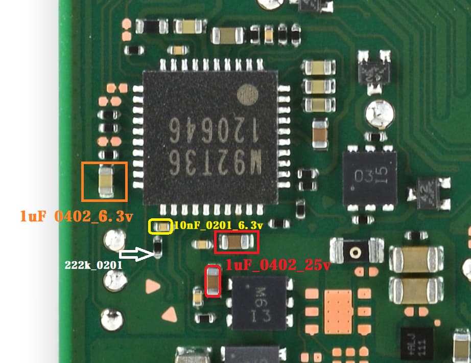

have the bottom two pair from another post. does any body know the other ones?
10 nf 25v 0201 cap
100k 0201 resistor
wow okay thanks! like the photo as well cut through straight forward appreciate it
hey sorry do you happen to have a link for the 222k resistor i cant find it.
https://www.digikey.ca/en/products/detail/yageo/RC0201FR-07220KL/3202393
220K OHM should work
