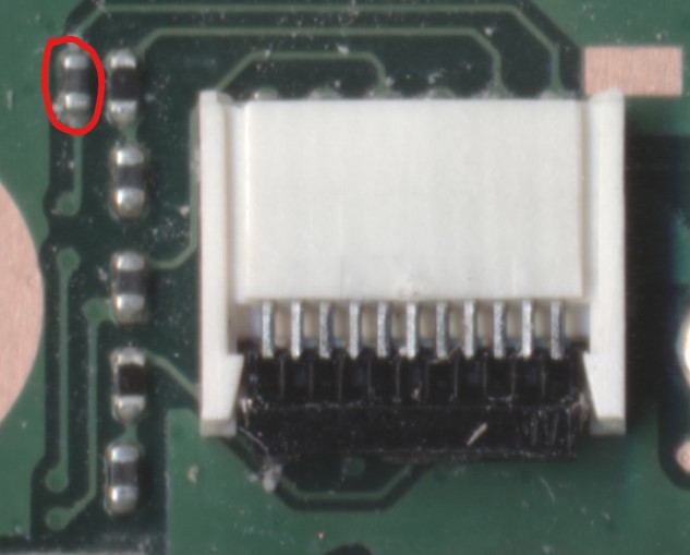

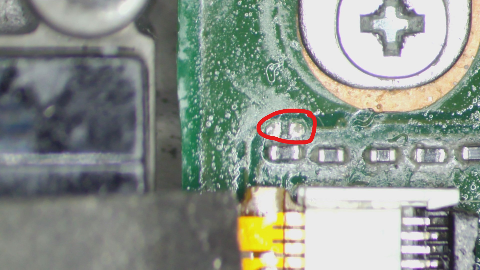

Have an OLED switch with right joycon not functioning. Upon further inspection, it looks like it’s missing this SMD component. Anyone know if its a cap / resistor and what value? It looks to be 0201 size.
Below is a additional picture that is a generic picture of a switch oled I located, see red circle for component that is missing.
Did you already know the value of the resistor? i lost the same resistor and now the joycon isn’t working with handheld mode. do you know which resistor i need?

I measured resistance of zero in a working board. I therefore just jumped the pads and the joycons are working again.
thank you very kind sir!!!
