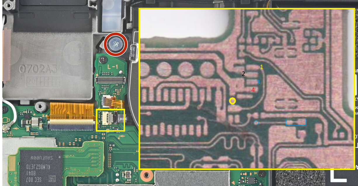

One of the pads of the fan connector broke off the mobo. Is this fixable?
So I purchased a V1 wirh a known issue ( the fan was spinning loud and constantly continuously), this apparently appeared after the seller said he took it to a repair service and they replaced the fan.
You can’t really tell, but there is fucking transparent glue on the connector. I tried to be gentle but the connector came off and one of the pads with it. (The last one)
I have a donor bord for a connector with a dead CPU. Can I jump a wire or something? Chatgpt told me that the pad is responsible of controlling the fan speed. (But can I trust Chatgpt?)
The 4th pad broke, the last one.
I really need to fix the fan speed, it is unbearable.
Not sure if you count pin1 from top or bottom.
And here it is, you could jumper yellow pin to the resistor bottom pad next to the cap on pin4 in red
I have done my best. I SUCK at soldering, yet I want to learn how to do it. I bought a couple of broken switches to practice. With my current toolset, it’ll be impossible to put the port back.
What I did was: I opened up the fan and where that ribbon cable goes there are 4 pins. I soldered a 0.1mm wire to each one of them and labeled them with tape. Then I went ahead and spend like 6h to try and connect the pins to the connector pads. (Again, missing pad 4)
ht tps:/ /ibb. co/VWLCn9rQ
This is my best result, I know this isn’t pretty. I am very very much a newbie. I connected pin 1 to pad 1, 2 to the ground point of that cap. (Used a multimeter to test which end of that cap is ground, could be wrong, I’m a noob)
3, to the 3rd pad and 4 to the bottom of the cap on the left of the 4th pad.
ht tps:/ /ibb. co/0R0qJFDT
Sadly, the fan isn’t spinning. I need to know why and how to test why it is happening. I’m really sad. I ran a game for like 2 mins without the heatsink in place for testing

if you look carefully, you should see the 3rd pin(blue) you jumper onto is at a wrong location
