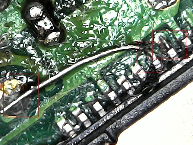

Hi, I have a power problem on my switch. I bought it broken and have been fixing it gradually. I first swapped the usb-c with a friend because I have never worked with a hot air station and wanted to see how to do it for the first time. He changed the usb-c but he riped 2 pads (5, 6 ). I found some informations about how to fix it and finally managed to do it. But the console was charging and docking only one way

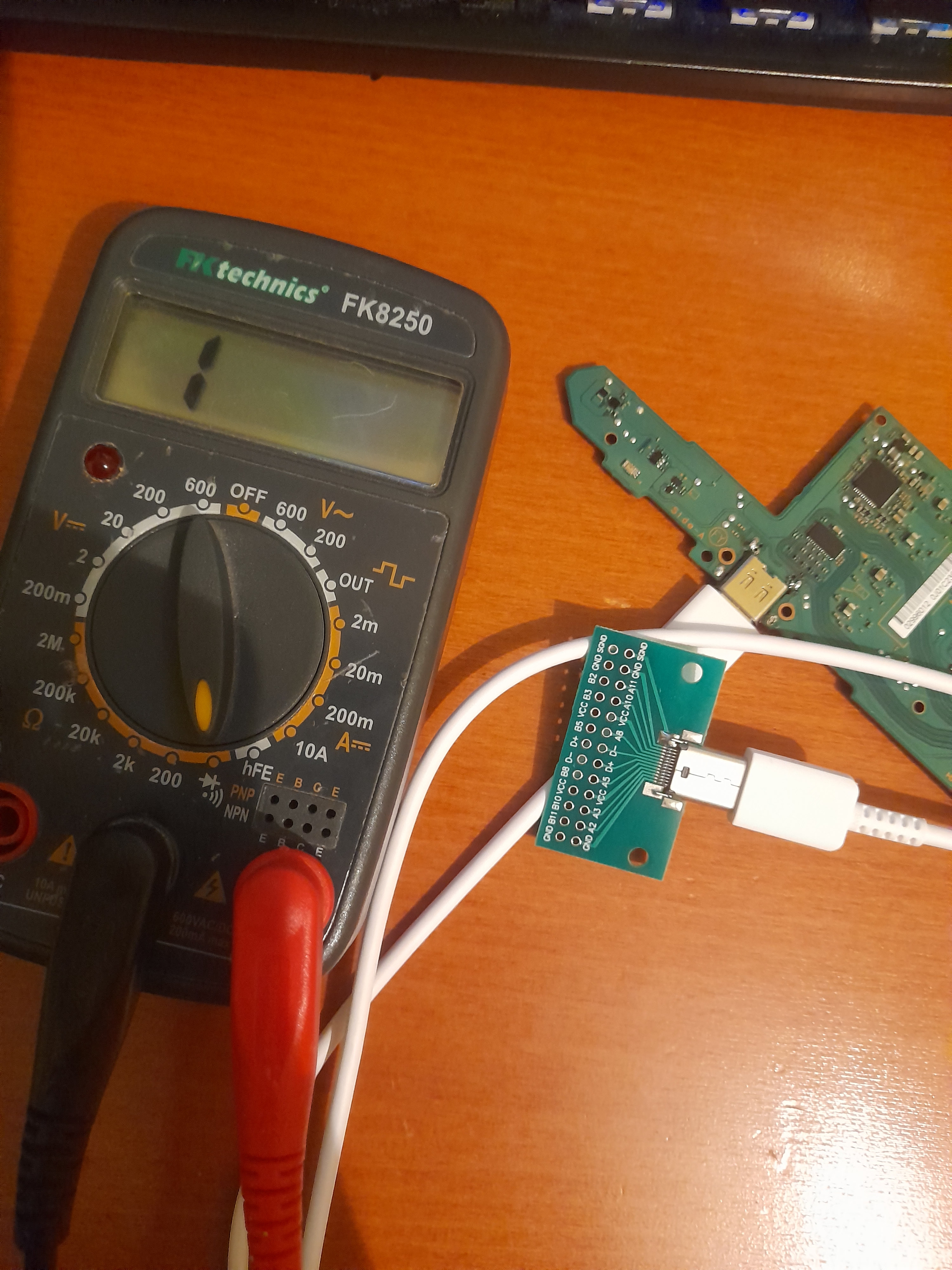

Hi, so i got the breakout broard and testeted switch without bettery but few thinks didnt beept on multimeter diod mod. So should I but battery in and test it again or … ?
If you use diode mode, you not looking for beeps but diode reading on each pins, otherwise you should use continuity mode to test each pin going through corresponding test point/location.
FYI, never do any reading or test with battery plugged in( except when voltage reading)
So by this picture cc1 is ok but cc2 is not.
But I tried if it leads through the breakout board to the usb c and led.
Btw Im not using official charger but my own for samsung + cheap usb cable.
