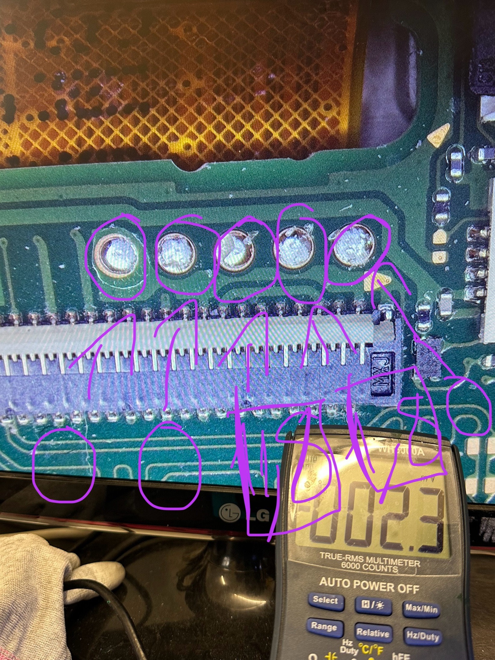

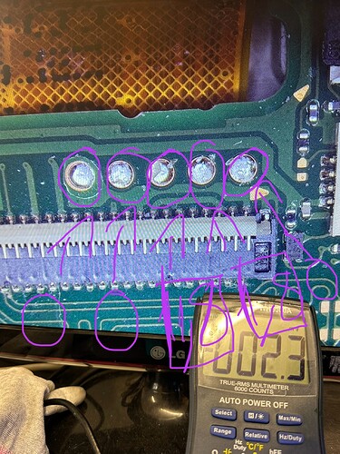

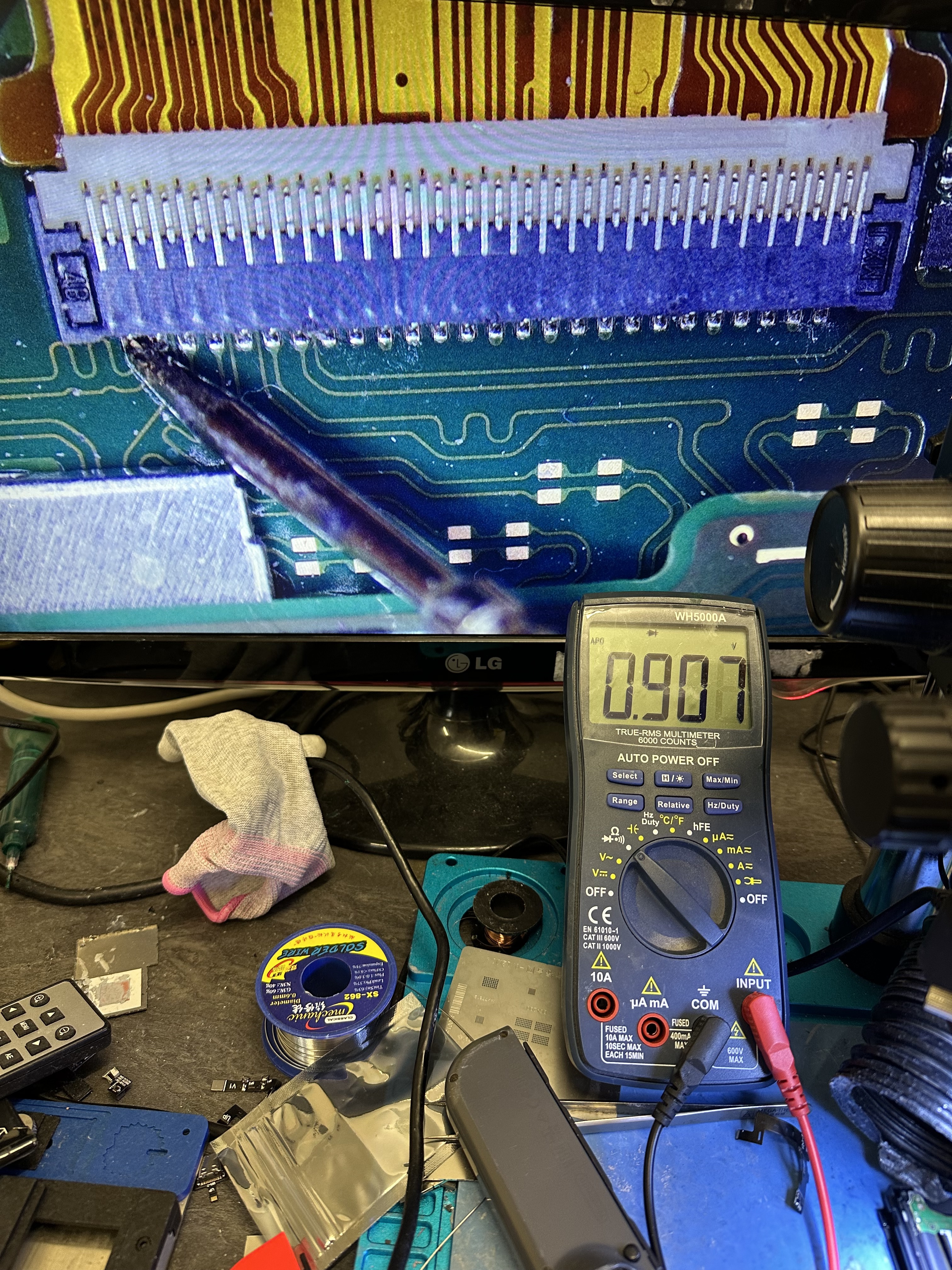

Can you post pictures of your install & solder joints up close so we can inspect? Also LCD connector and general area for good measure.
Does your board revision have the filters nearby the LCD connector?

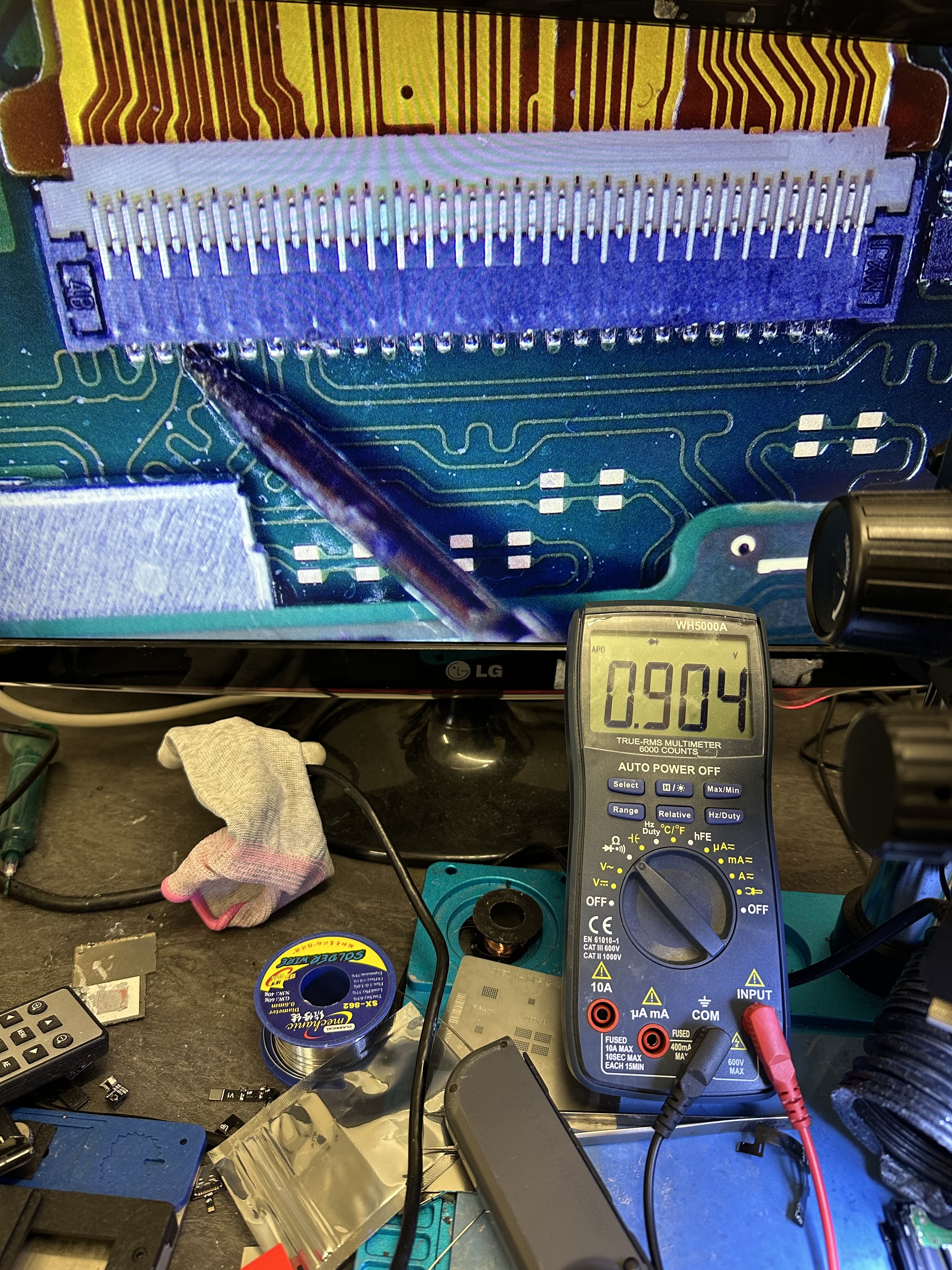

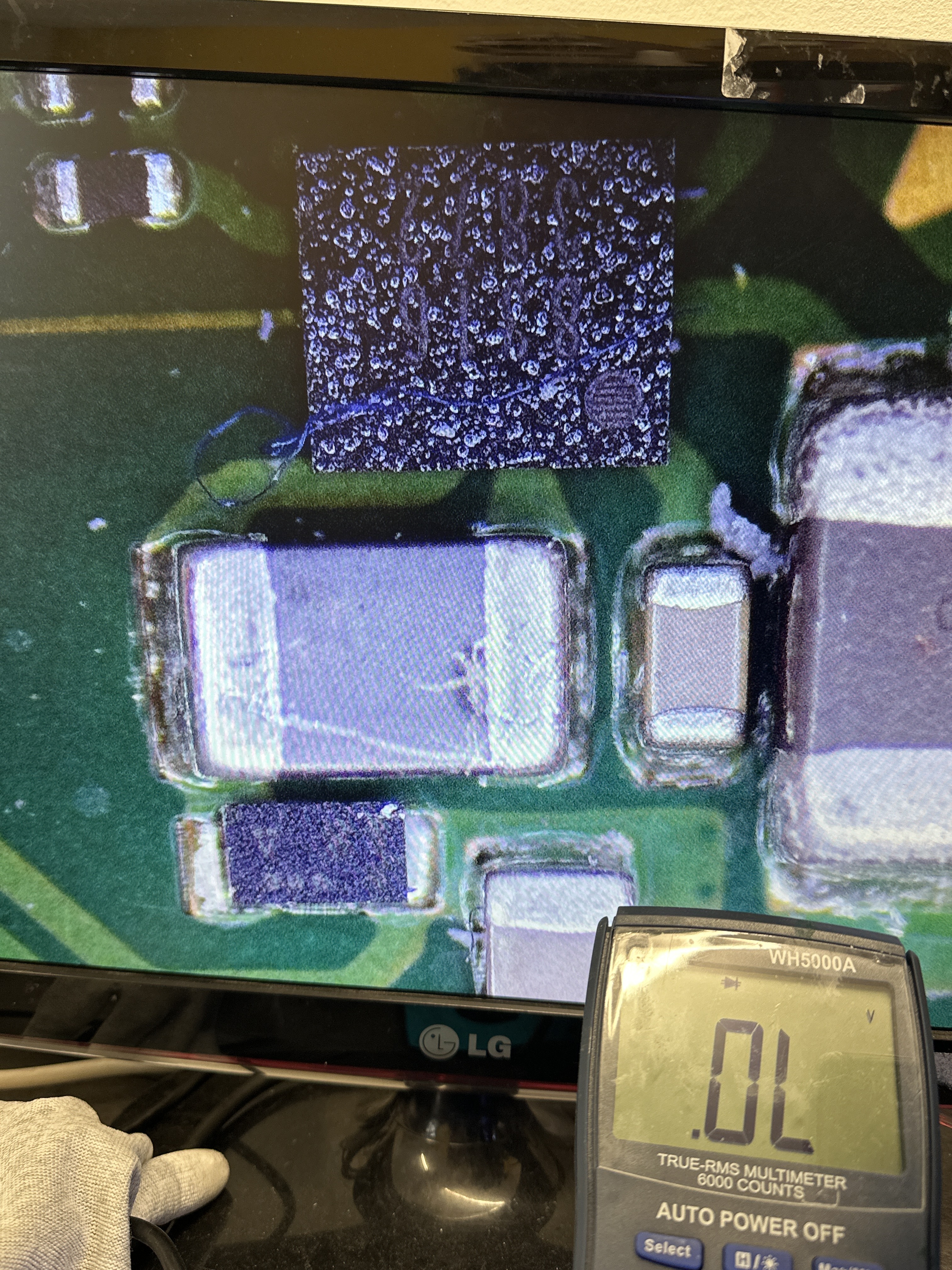

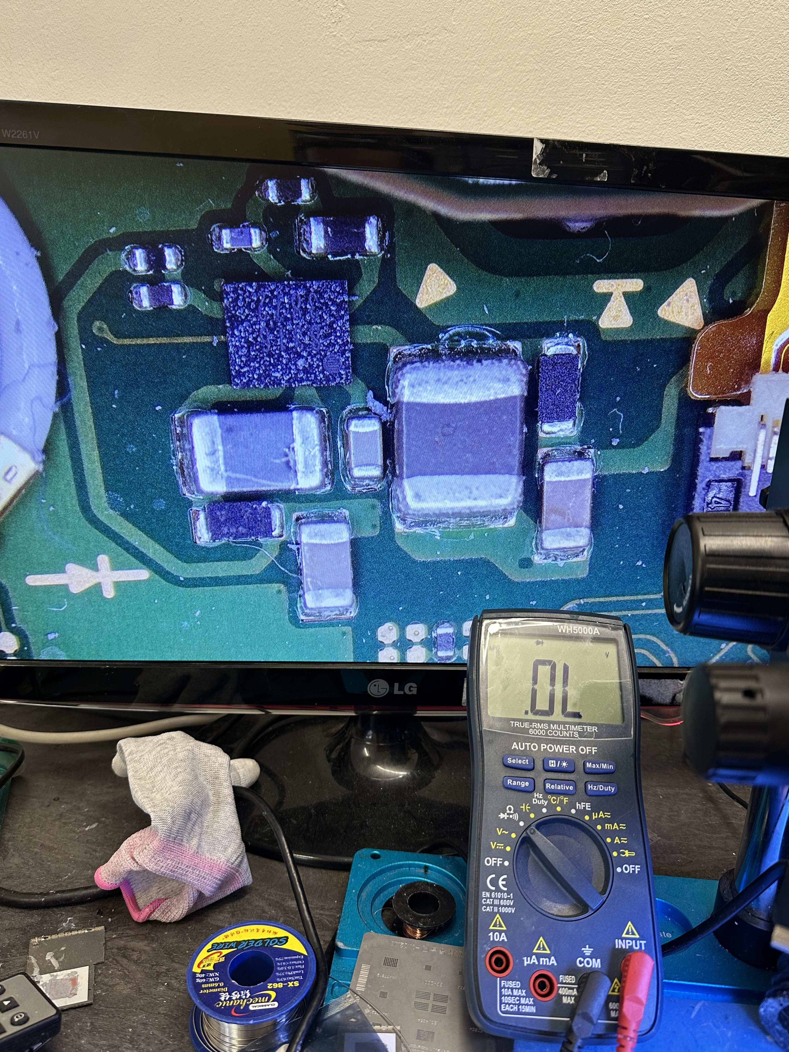

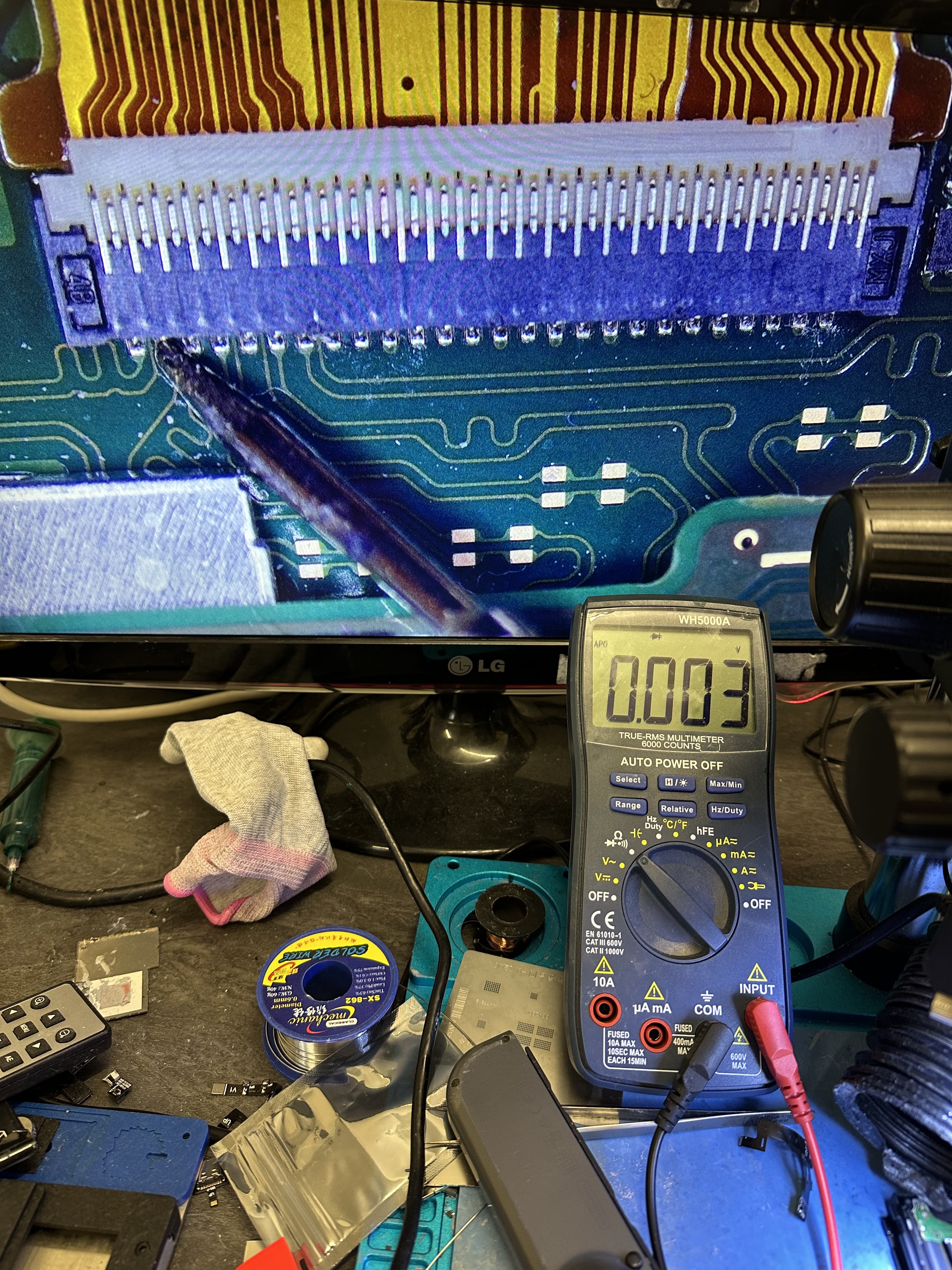

rails 1V8PDR and 3V3PDR too (if i recall correctly) is present on the lcd connector and are required for display, Picofly utilises these rails. Unlikely but maybe a bridge, dead short or partial short is dragging one of these rails down, low enough to prohibit display but enough for the console to boot… unlikely but we’ve seen boards here boot with a near dead short on 1V8PDR before.so worth checking… worth checking restitance to ground on these rails anyway given how poorly designed some of these modchips are incase one is low
Failing that it’d be looking at the usual suspects like the 8316 IC and/or support circuitry etc though can’t think why that would have failed unless you were hotplugging it…

I have swap one ic 8316 ans alls cap and now the display work !! Yess but feez after Nintendo logo :unamused:
