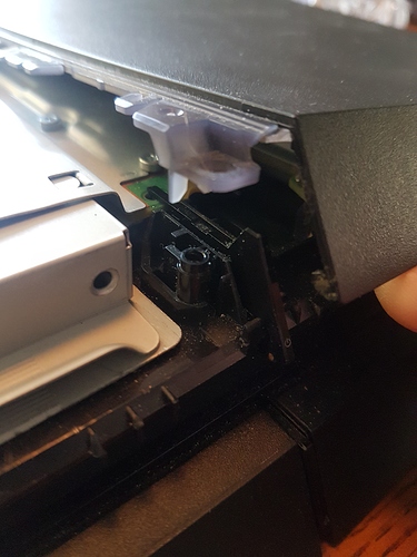

As for power button, take both top covers off and inspect it. It’s just plastic tab so it’s likely that it broke. If the button isn’t broken, the actual power button on the sister board may be broken. You’ll find that screwed to the disc drive. Very small board with two little silver screws.
Ok. Thanks for the info! Do you know where I could find a picture of the plastic power button, so I could see if it is broken?
It sits in here. If the plastic tab looks fine, the actual button on the piece of the board you can see might be broken. You’d have to open up the console to see that

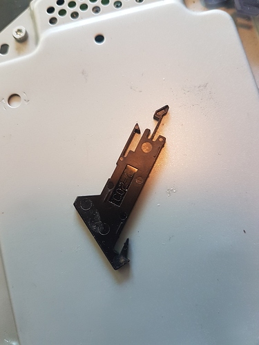

Thanks for the pictures! The plastic tab was broken. Do you know if I need to buy a new motherboard if I need to replace the bluetooth chip? I don’t have a soldering station. I’m going to test the controller things that you mentioned later.
