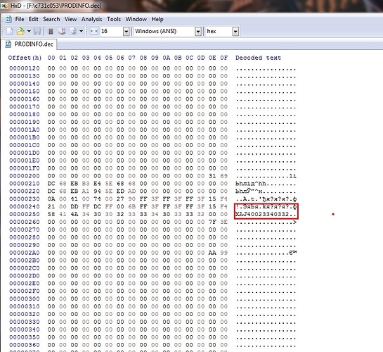

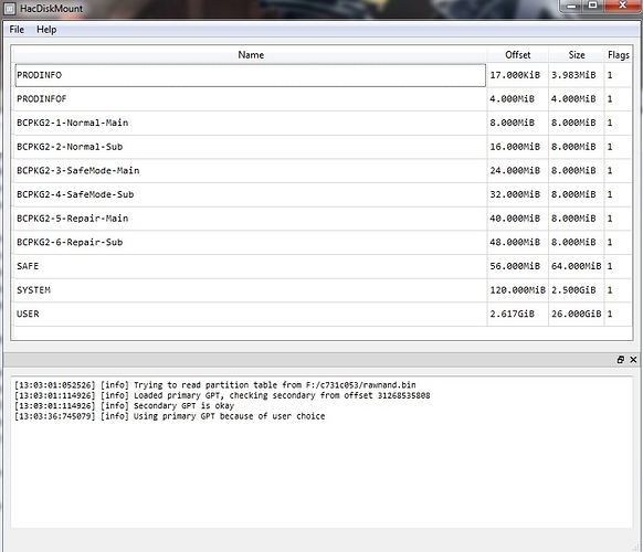

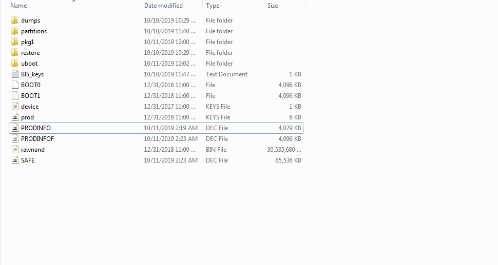

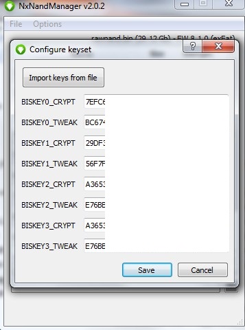

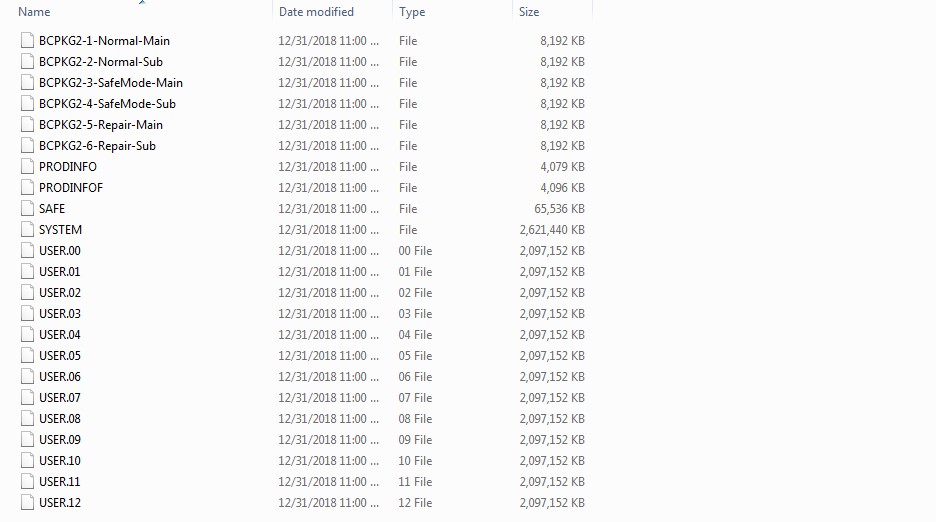

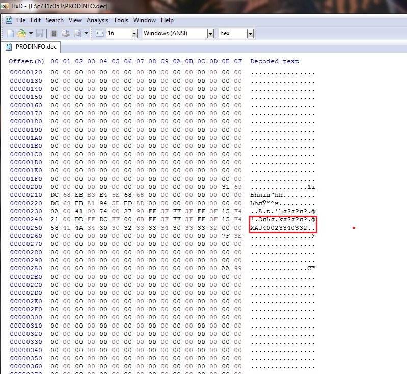

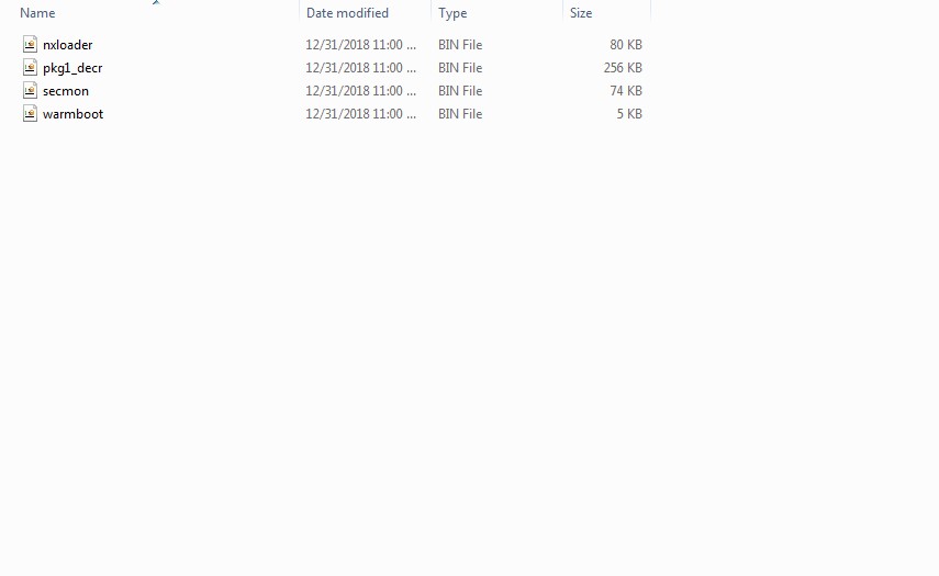

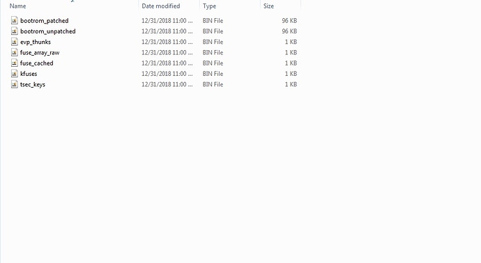

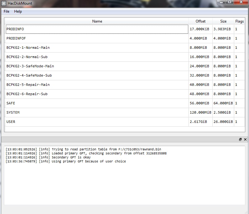

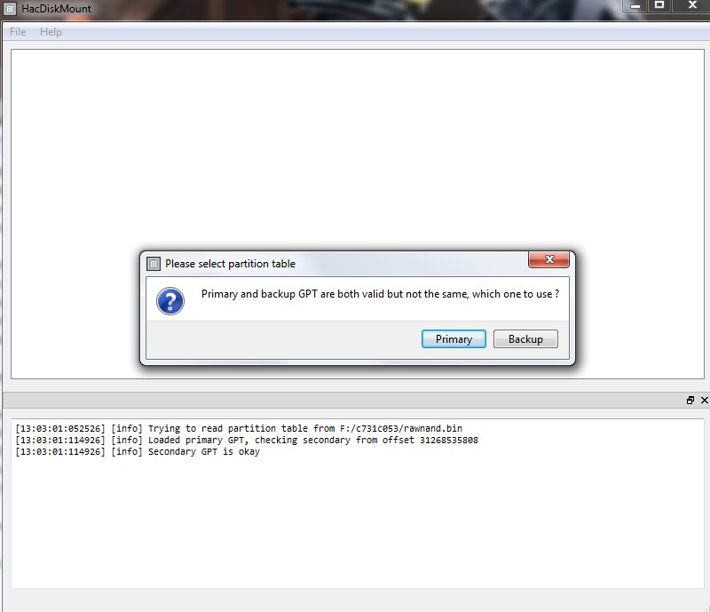

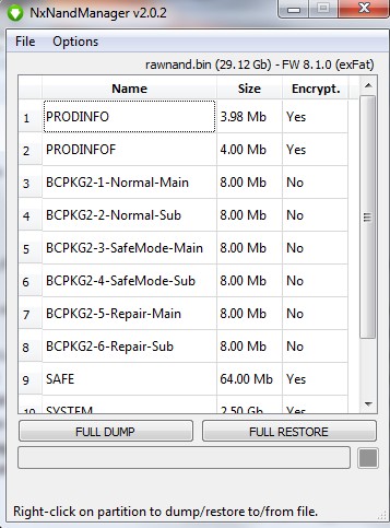

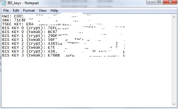

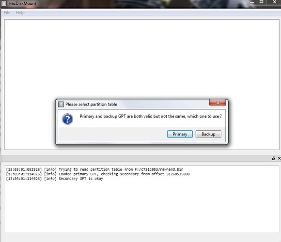

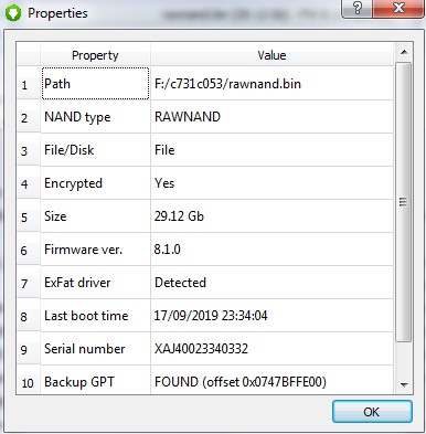

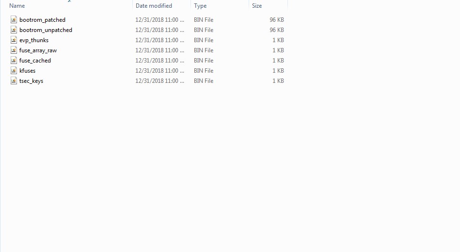

First of all, I want to thank you for your hard work and support for this community. I dare to appeal to you in this way because I can not handle it in the situation that I will explain to you and I am very confused as to why I read all forums in almost similar cases. I hope you have the patience to read and maybe you can help me too. I got a switch from a friend who made the next big mistake. Switch was with cfw SXOS on system 6.1.0 and tried to update to 8.1.0 It had emunand installed. I don’t know how the bricked succeeded, without having a nand dump. Now at startup Switch gives blue screen but if i launch payload hekate in RCM mode with TegraRcmGUI, goes I could do nand dump, partitions, biskey, etc. I’ll attach pictures to see what I’ve done so far. What do I have to do to get it back to life ? I do not know how to recreate the valid nand from the data if I have. Can you explain to me that like a noob what follow the steps I need to do ? Thank you for your patience and forgiveness for my bad English language.

Edit: What I think is a bit disturbing is the message you get from HacDiskMount. Did you try injecting gptrestore as payload from TegraRcmGUI? If you’re extremely lucky your GPT is just broken. Also, it’s a longshot, but try getting known good BOOT0 and BOOT1 images (those are not console specific) and try to copy those to the switch. Don’t get your hopes up, I don’t think it will work…
I agree, the GPT is the bit that worries me. I had a once I fixed with a corrupt system partition and broken keys in prodinfo before, so not quite the same. What I did to get it to a “known good” state was to actually work to backrev the code to 6.1 then, once the partitions were stable, upgrade it back to the version it was at before. I found that version by checking the blown fuse count. The backrev would have to be done with ChoiDujour(not ChoiDujourNX) unless you can get it to boot to something like atmosphere(In which case you could use ChoiDujourNX). The important parts are the PC version ChoiDuJour only supports up to 6.1, don’t use anything newer… You’d need the firmware package as a .zip and I don’t think sharing/hosting those is legal. You’d also need the exact non-system specific keys for 6.1 with no extra keys. Those keys are also legal to share/host. I can say this, the exact key’s you’d need the values for downgrading to 6.1 are these and only these:

Hate to reopen this but I’m currently going through the same issues, done everything I can. Looked everywhere but everything I do results in Entropy failed test in hacdiskmount which means my keys are wrong but I have dumped my keys in every way possible, through lockpick and hekate and I always get the same keys yet when I compare the crypt ad tweak, they don’t match and I’m at a complete loss.
