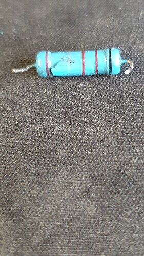

Hi, can anyone help me identify the value of this resistor? Tried online but they won’t let you select black as first colour on 5 band. This is on the dc negative out from a bridge rectifier.

Hey,
Afaik this is a four band, think of the black as zero.
Bit hard to tell the colours from the pic so you may be able to better determine them and use the calculator here
Thanks pal, seems to be black, brown, red, silver, brown. Found another calculator that listed that as 0.12ohm so have ordered some 3w ones about the same size. Fingers crossed
