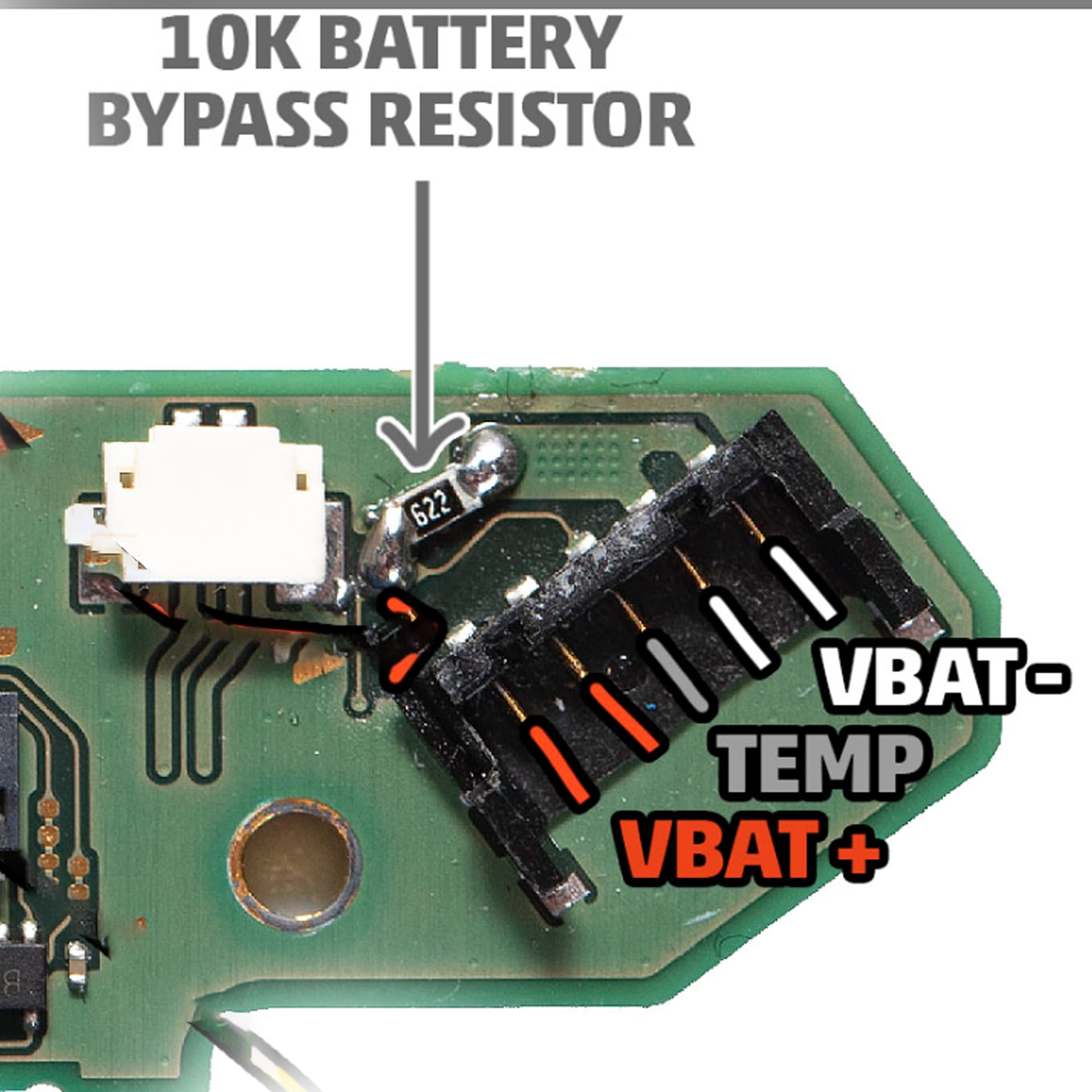

I have read somewhere that if you need to power the Nintendo Switch from a Bench Supply at the battery input (To detect a short) you will need to install a 10k bypass resistor across the plus and negative ternails at the battery connector as shown in the image
I would take the reason would be to limited the current draw or to make the current flow??
To be honest I do not know
Is it nessary to do this and if so WHY??
Thank you
The console wants a battery installed. More specifically, it wants to know that the battery is at a safe temperature before booting up.
The TEMP line goes to the thermistor in the Battery Management System on the battery itself. Soldering the 10k resistor mimics the thermistor’s normal load/signal to trick the console into thinking it’s non-existent battery is at a safe temperature (~25℃), allowing it to boot.
We derive temperature from Negative Temperature Coefficient thermistors through fluxuations in their resistance. Their resistance at room temp (typically 25℃) is one of their key parameters.
