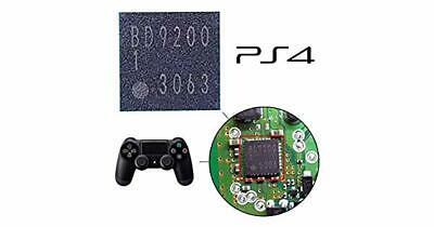

Sounds like your power control chips gone bad mate you can buy them on ebay here’s the link to one should you need it
Well I don’t have a soldering iron nor do I know how to solder so if that is the problem I’ll have to get a new controller, at least until I get the knowledge on how to solder, I watch both TronicsFix and My mate is vince and it doesn’t seem too difficult but then again they are experienced I’m not.
Got a bit of a question keep in mind I’m not experienced with this at all, but if it is the power management chip should the controller not work as a wired controller as doesn’t that chip manage the power coming in from the ps4 as well as from the battery? The ps4 controller works fine if connected via USB. If the power management chip was faulty I would assume the controller wouldn’t work at all. When I was thinking about this I thought maybe the ps4 manage the power itself so I plugged the usb into a adaptor plugged into a outlet and it still works as I can turn it on and Bluetooth it to my phone.
Could just be a partial fault
K well I know someone who knows how to solder so I may buy the chip and get them to give it a go or I may just use it as a wired controller as I really don’t mind I’m just curious on what happened.

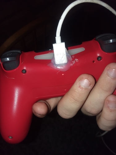

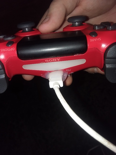

Man wireless is annoying every usb I had wouldn’t stay in and when it was disconnected the ps4 doesn’t immediately recognize that the controller disconnected and it almost killed me on the long dark as my character continued to walk forwards what I did to solve this issue is to glue the charger in place from the inside out (I made the hole where the charge port sits in bigger so It all could bond. It’s a sturdy connection, so for a ugly patch it works
Well that’s a simple solution to a really annoying problem nice hack mate I love it
Yep, still works too and the controller has been dropped a few times while I was getting used to it being wired and it is still strong, when I did that I swore it wouldn’t work at the very least I thought the glue would get inside the port preventing the pins from making a contact but it didn’t and has been working since, best of all it stays connected so the “fix” worked as intended
