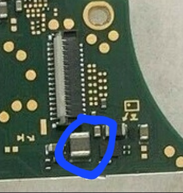

Hi… i removed emmc from my switch lite because i bought it broken with destroyed pads. So before do a reball i was analising the board and saw had a question… this should have continuity between? In diode mode it gets 0 both sides
The big component is an inductor/coil for the LCD power ic next to it and in this state’power off’ it is ment to read approx 0 Ohms.
