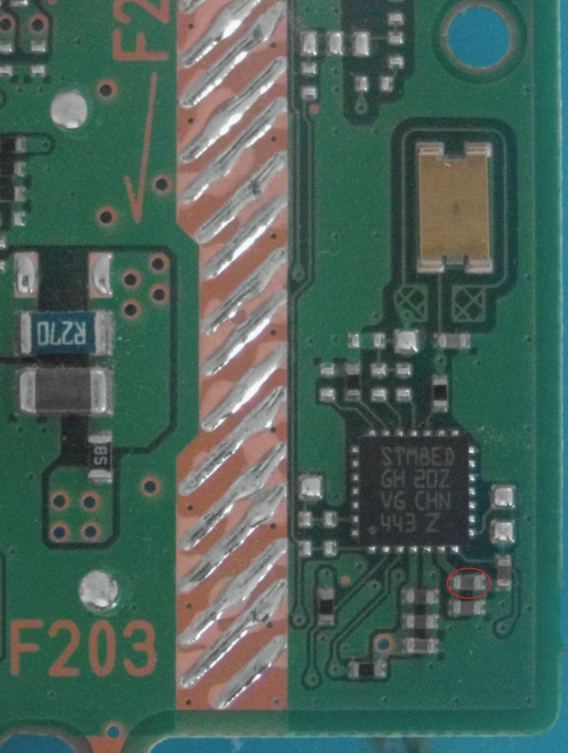

The drive reads games fine, i can play without problem but, big problem, the eject button didnt react at all…
I swap with an other daughter board and i hear the 3 bips when the PS4 is plugged.
So i think that i have a problem with the original daughter board but i dont really know how to search.
Could the STM8ED be eventually faulty? or have you any other way to search please?
Thanks all!
Update: it test tensions on the daughter board and i have 0v instead 1,5 on the encircled point.
So i will shop an other STM8ED chip and swap it.
I will send the result when i will have done it

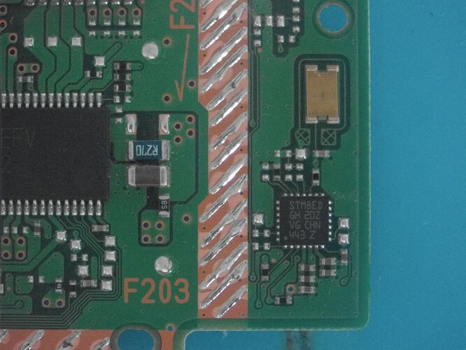

Hello everybody!
After changing the STM8ED IC the drive is fully functional. That was this piece which was faulty.
