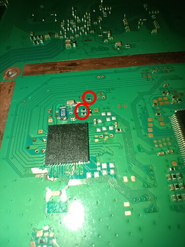

Hi everyone. Recently i’ve gor myself a PS4 with liquid damage. Console itself is working fine but there is a broblem with a BD drive. It’s taking discs no problem but wont spinning them. My guess that Renesas is OK. I restored a couple traces and replaced a BD7764muv ic. Same behavior. When i tried to find another faulty component i discovered that 3 resistors brobably dead. I know that the one on top is probably 10k value, but i was unable to find correct values for other 2. Would aprreciate any help. Thx in advance
