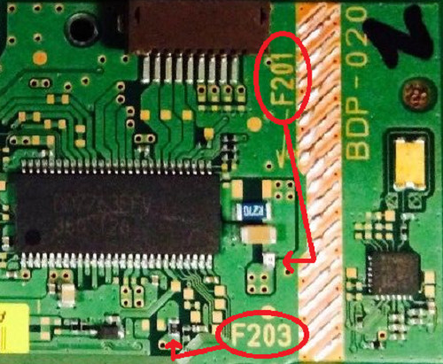

CHECK DAUGHTER BOARD fuse continuity
So I couldn’t find any issues with the fuses or randomly testing caps. I tried another drive and at first, it would accept the disc and read it but still only 3 beeps when trying to eject. I decided to just go ahead and swap the chip on the daughterboard to another board of the same model (BDP-025) and now it won’t do anything and seems to be killing drives because now the drive won’t accept discs at all even with a different daughterboard installed. I’m going to order a drive because I have been using ones I had lying around but I doubt 4 drives would be bad. I’m also going to try to get a different flex cable that runs from the mobo to the daughterboard. I’ll update once I have done that.
