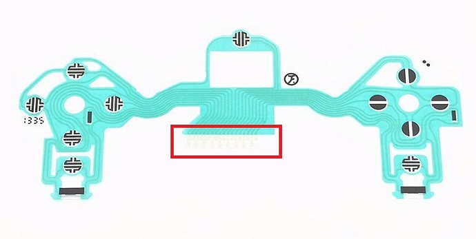

I already handle a few of this case, i think the problem is on the conductive film socket. Many time i found it won’t touch the board below. You can strip up your controller and try to give a little bit bump like tiny tissue on the conductive film socket so when you reassemble the controller it will give more pressure to the conductive film so it can connect to the board.

Thank you very much, I know know why it activates on its own also when I press on the L3.

Before you tried to strip it be sure you have all the equipment, also the video link that i will give you is only for 1 type of controller but overall it’s should be the same and what i give you is the tutorial about replacing the conductive film but in your case your conductive film is good the only thing you need to do is give a little bit bump (you can use a tiny piece of tissue) on the conductive pad.
Also here’s pictures for the bump :
