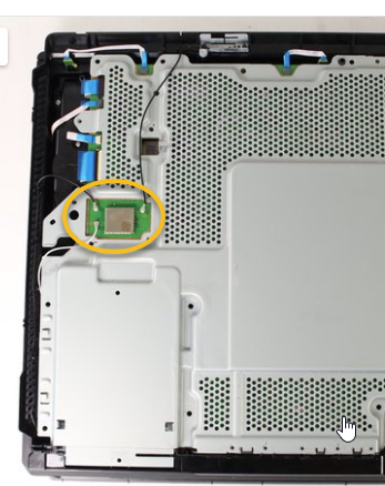

On the motherboard there are three antenna connections, these connections and chip are responsible for all wireless connections to the PS4, maybe one or more are loose? The easy part it is simple to check as all you have to do is take the bottom cover off of the PS4 and you will be able to see them. If all three connections are good then the chip might be faulty and will need to be changed. This chip is available from ebay, and it is a BGA style chip but one of the easier ones to replace. Any qualified electronic repair shop should be able to replace it for you. Simple thing to try rather than get a new PS4 Pro.
I was going to open it up when I remembered its still under warranty. So I decided to send it in. Thank you very much. It was driving me nuts on what the problem was
