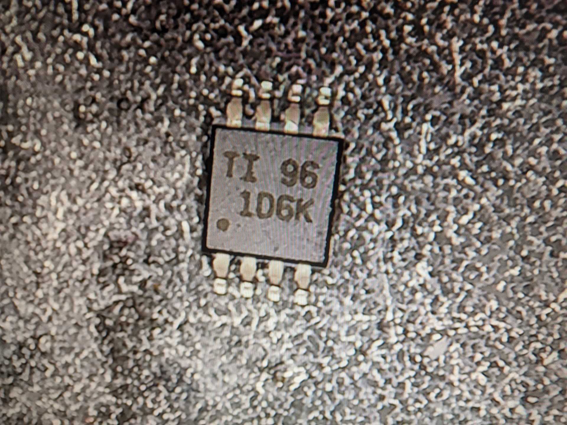

Ps4 pro - looking for ic next to rear usb port - TI96 1D6K - img below
where tro get this part or similar? couldnt google it.
I know PS5 uses TPS2001CD. PS4 should be interchangeable or similar

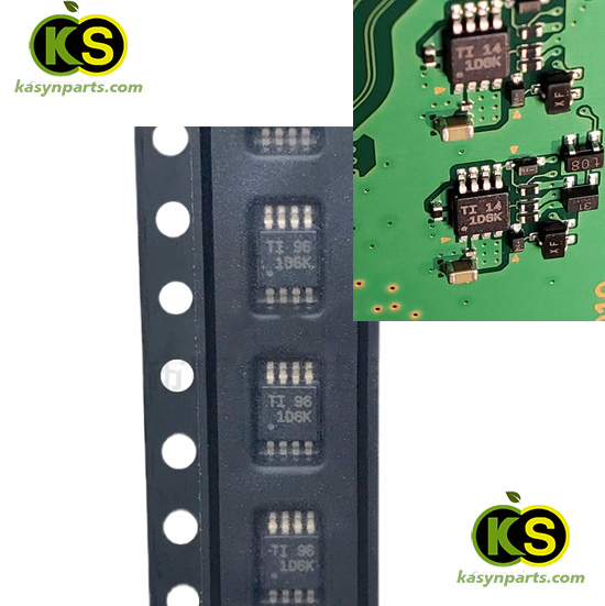

USB power switch Charging control IC kasyn got this chip
1D6K turns out is TPS2001DDGK, on the same TI TPS2001 series
