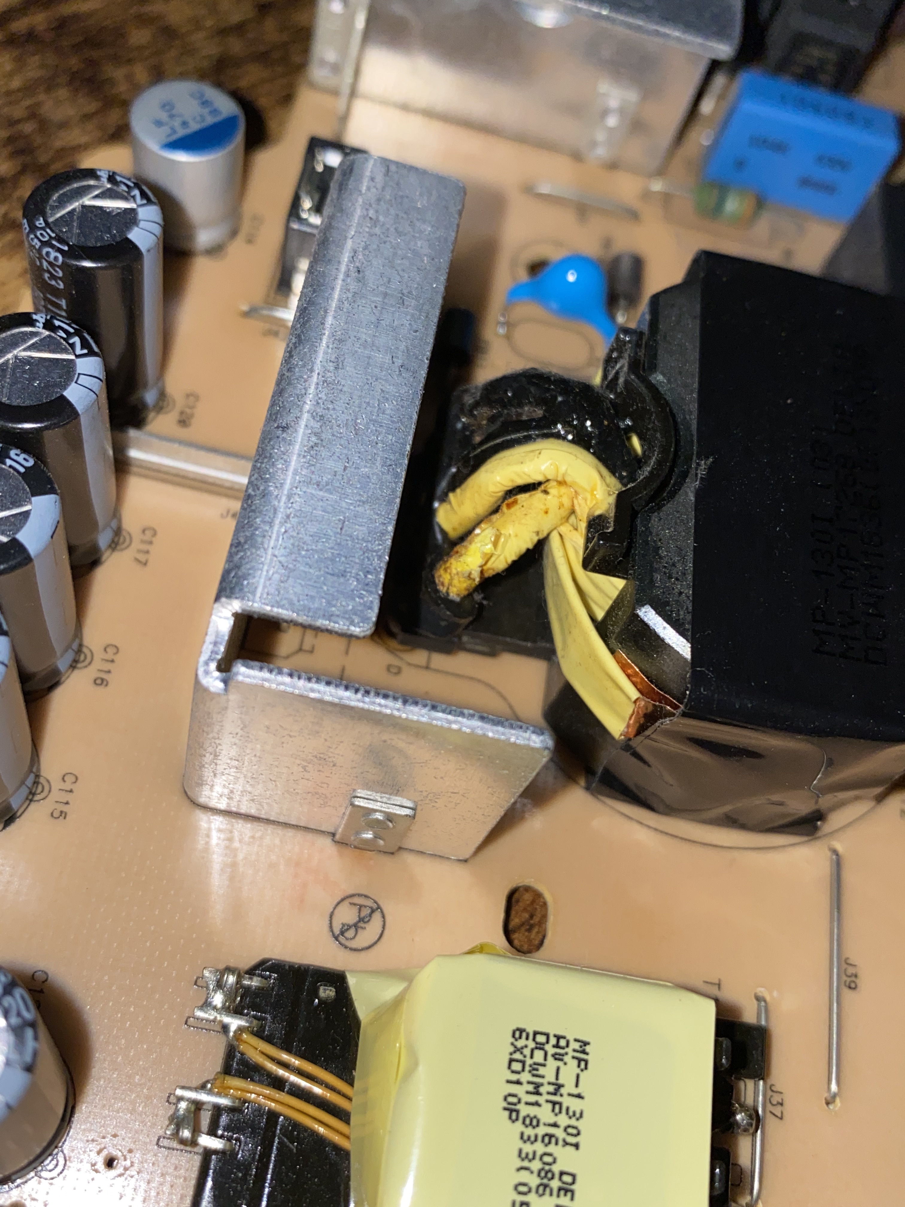

Does this wire on the power supply look normal to you? To me it looks like it could be the cause of my ps4 pro not turning on, but i’m not for sure!
image|375x500
looks like it has seen better days, but have you measured the pins on the small flex cable that connects the PSU to the motherboard? If you plug the PSU in you should be getting 5v on two of those pins. If you are not getting anything on any of those pins then it is safe to say the PSU is bad.
I’ll have to try that here in a bit, the closest thing I have to test it right now is an led so ill see what I can do
