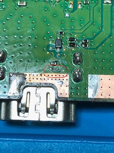

I just swapped a new HDMI port on a PS4 Slim model# CUH-2215A, with SAF-003 board. The following diode came off from the hot air circled in red.
I am looking for the ratings of most ps4 dj diodes to purchase at mouser or digikey. Or a direct replacement part listed online, preferably not Ebay. Thanks!

je les achète sur aliexpress , je ne peux pas mettre le lien mais en tapant : diode dj hdmi ps4 ça devrai fonctionner. Bonne journée
