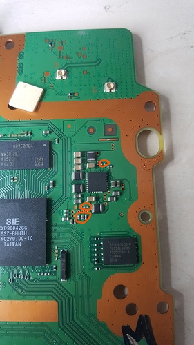

My PS4 slim has no power. No lights, no fan nothing. The power supply is tested and ok.
I’ve found some capacitors that are shorted to ground on the logic board. Can replacement fix the power issue?
Replace that IC in the middle and check all fuses on the board. Let us know how it turns out.
