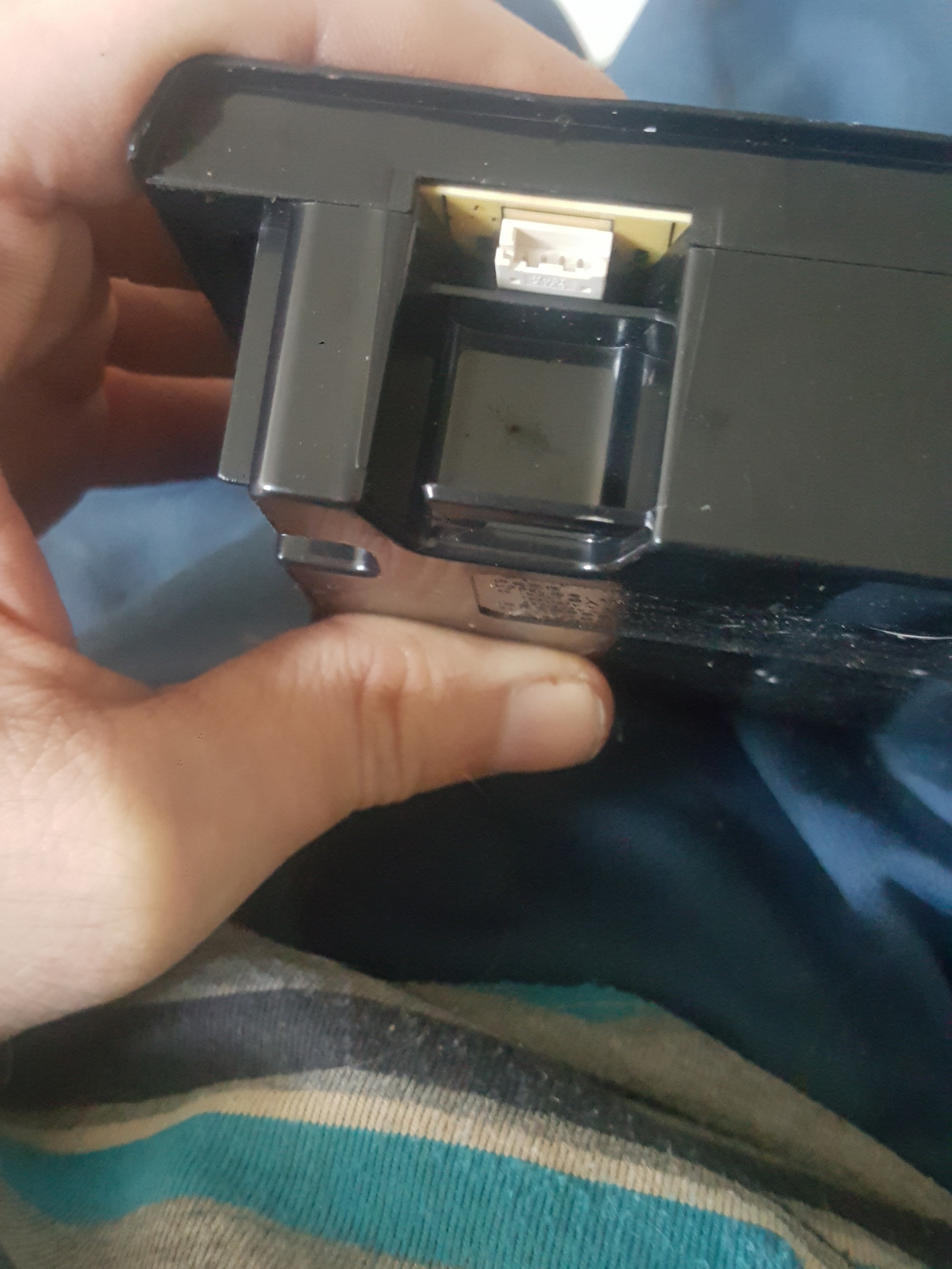

It’s your power supply mate i’ve fixed several ps4’s with that problem and it’s always been the power supply

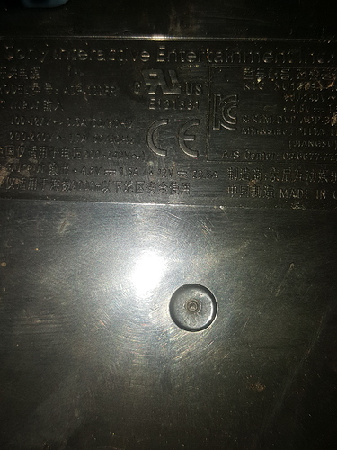

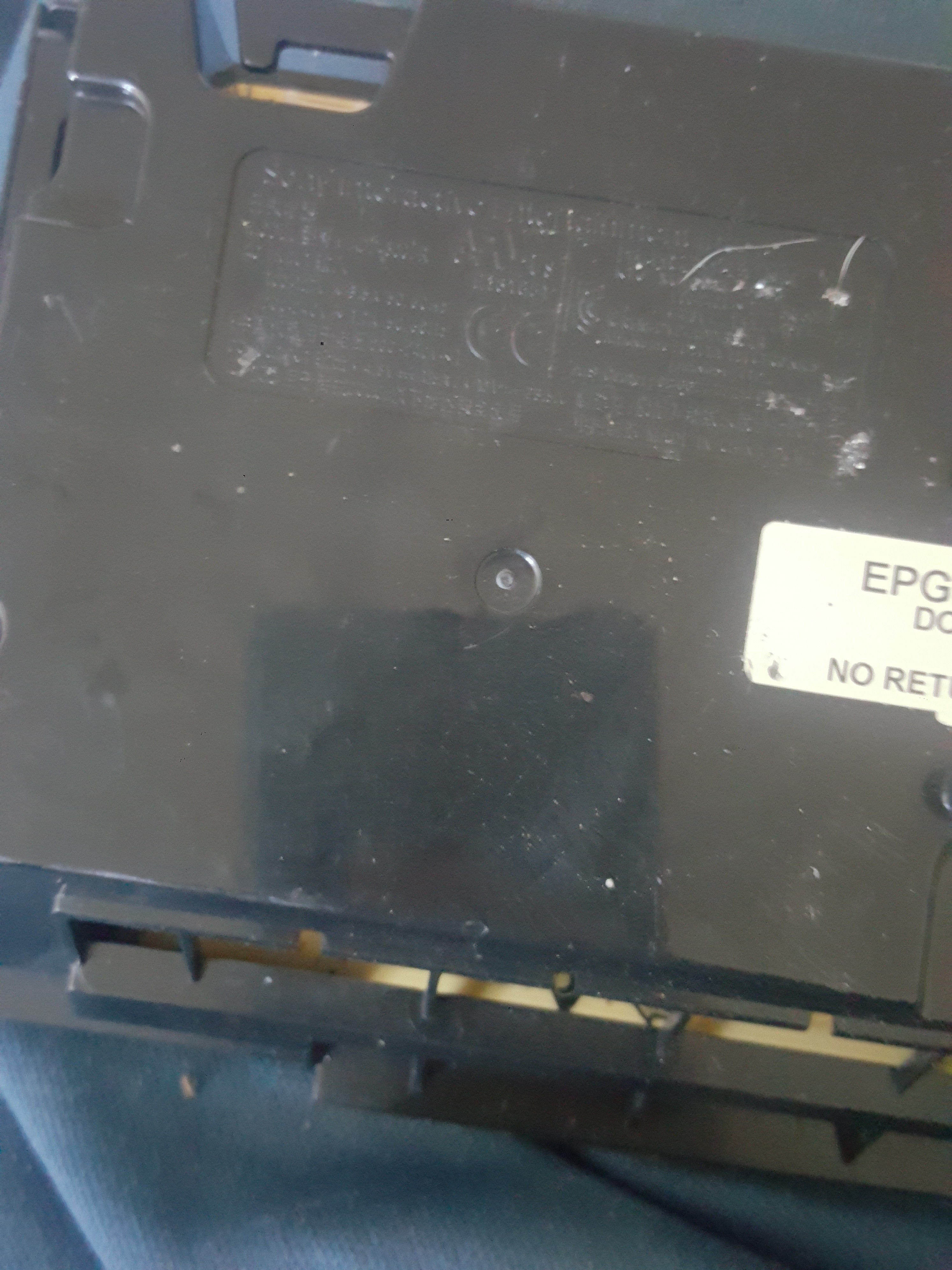

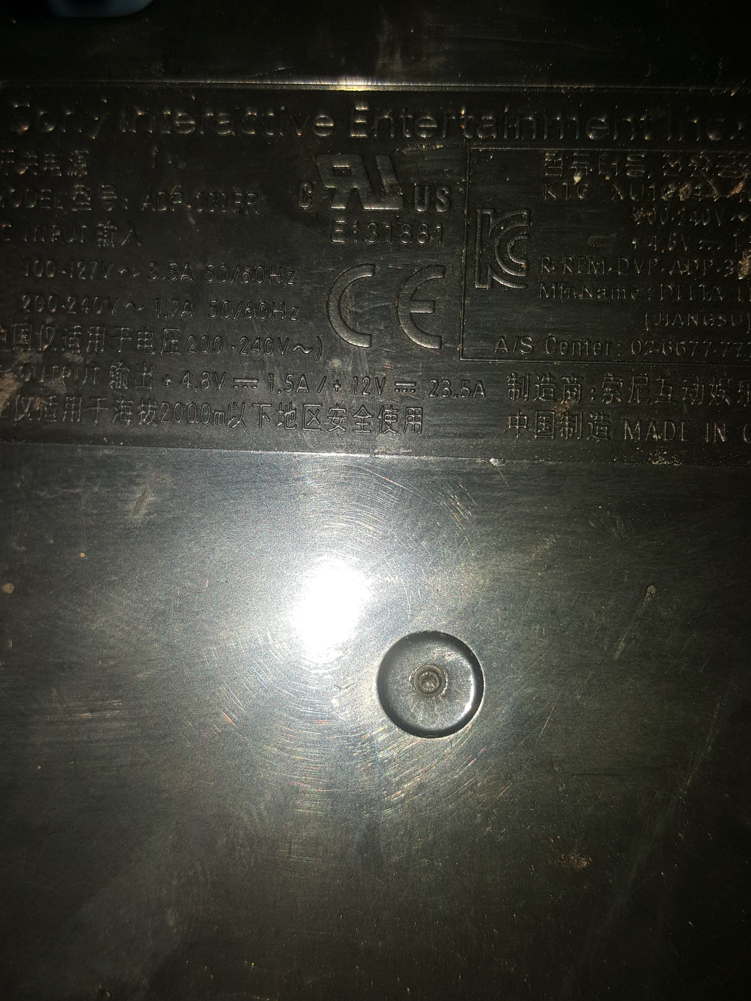

It’s located at the top just pry that off to get at the bottom screws you’ll require a t10 security screwdriver here’s the type I buy they are cheap but good

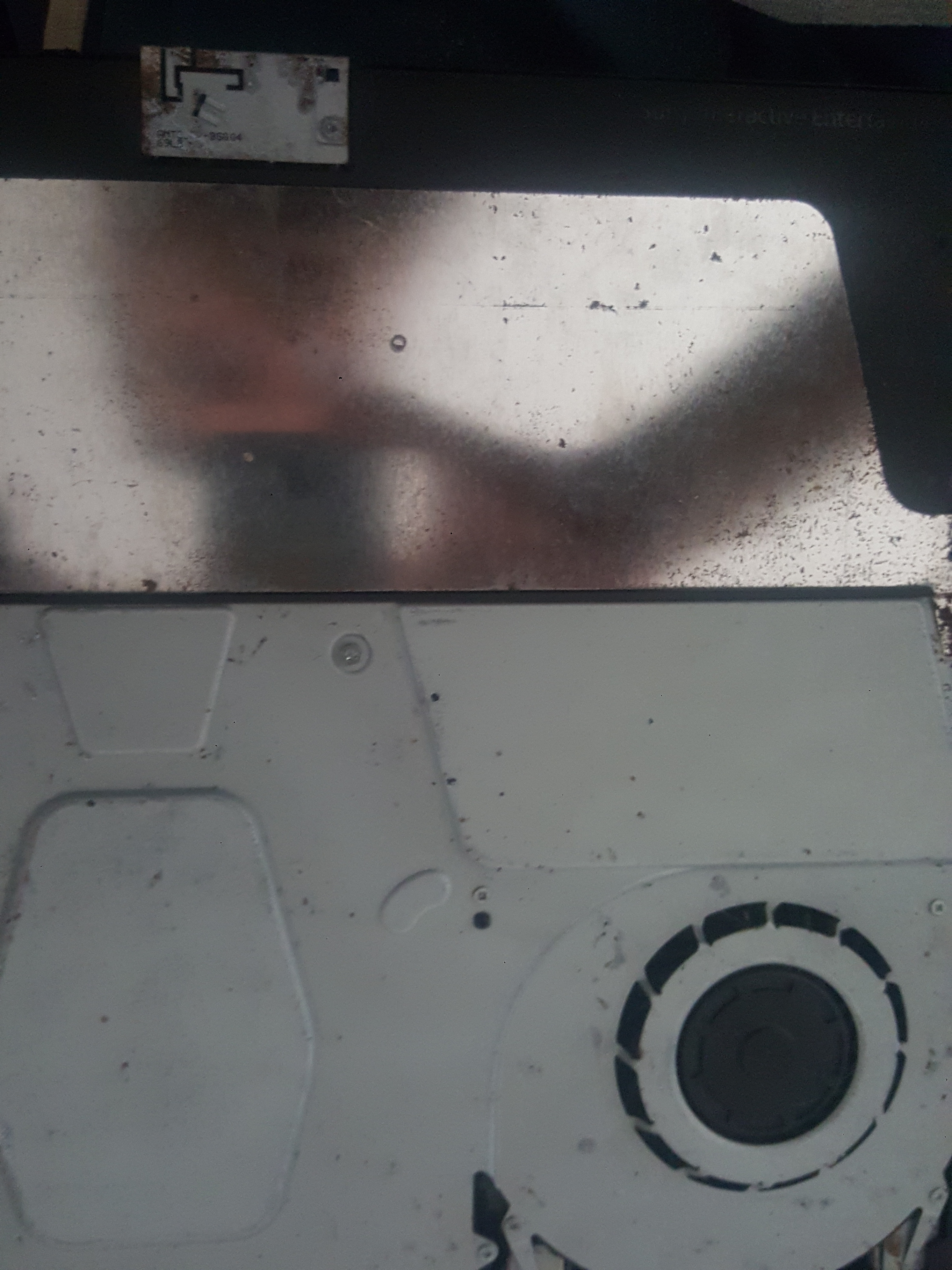

I see roach droppings…
Yep an old roach fried one I kept for reference as I meant to replace it but haven’t yet we had a bit of a roach infestation hopefully yours won’t have the roach droppings both those psu’s are fried
