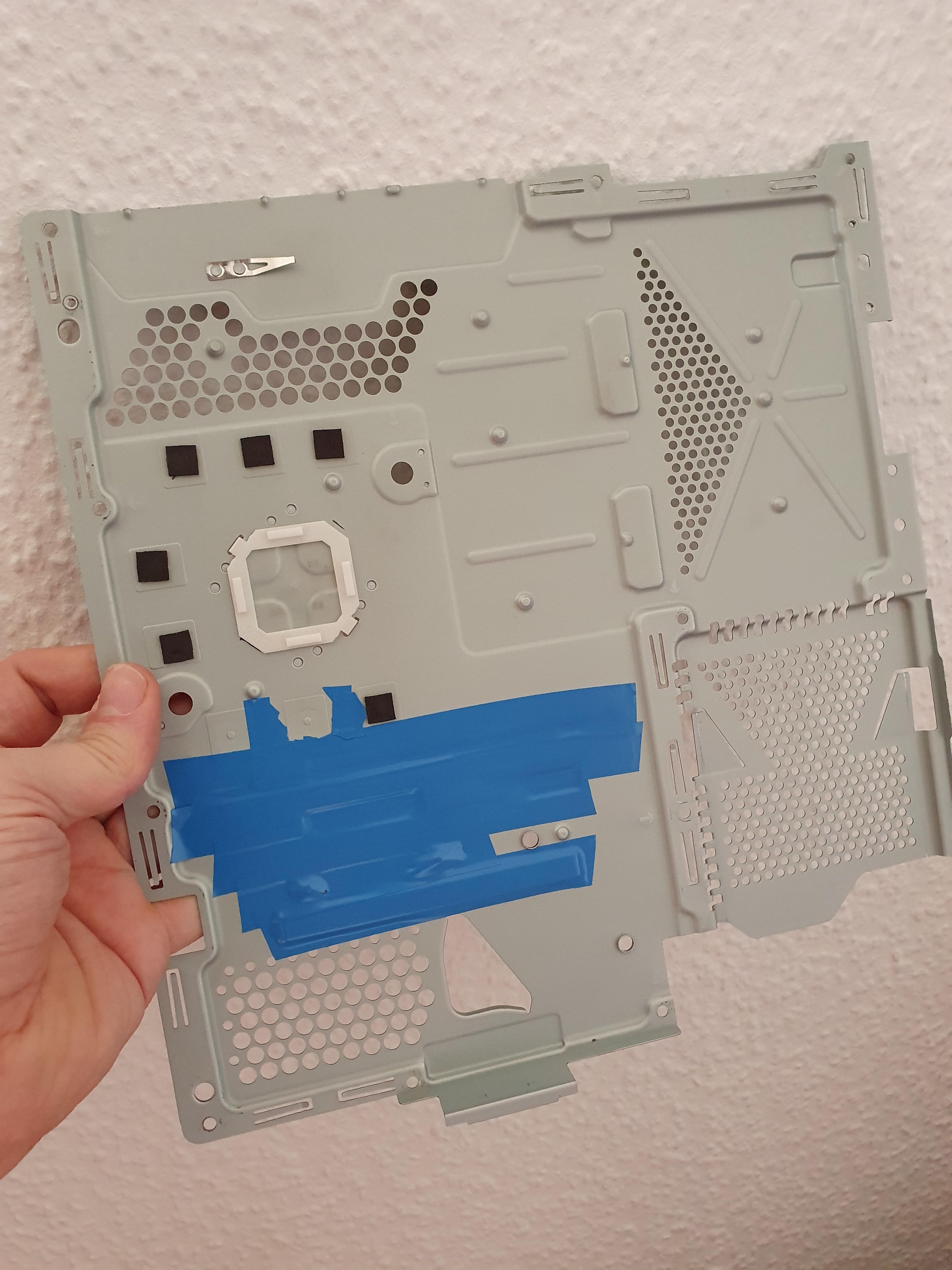

so I have some good news here first. I got it fixed. It was not the PSU. After several hours tinkering around on my PS4 to test the behaviour of it, I found that it shuts down when pushing a tiny little bit on the shield that covers the “B-Side” of the motherboard. I found this out during the test with the “washer-method”. You will find this method on Steve’s basic video about the PS4 On/Off problem. After it worked fine for a while with two washers on each side of the screw, I thought at first this would be the fix and thus that the cause was the APU with some loose solder joints. However, later on I found by accident that it still would shut down immediately when I pressed on that shield. I inspected the shield and found that it was slightly bent, and there was even a dent in it where it shouldn’t be. So, I assume that this caused the shield to make connection to some of the board’s components and as a result shorting out some circuits, which then caused the system to immediately cut power (thankfully just that and no blown parts…)
I then carefully tried to apply some pressure to some points of the shield and made effort to bend it back as good as I could and also removed the dent by shaping it with some metal tools. To be on the safe side, I also taped off the corresponding areas of the shield to prevent any unwanted connections.
I made another critical mistake during this repair, when I put it back together. I forgot to insert the plastic part that keeps the shield away from the bottom part of the APU. As a consequence, the PS4 also shut off immediately when I turned it on, because the shield caused shorts on the components in that area. I am lucky that nothing broke during that, please don’t make the same mistake!!
After all this it runs without any problems.

You are probably right. After playing a few hours, the PS4 shut itself off again. I was able to watch a full BD-movie at first and since it took a while for it to shut itself off again, I thought the issue was fixed. It doesn’t power off when I press the shield though, so maybe there were more than one problem going on with this. I will put the washers back on and see if it fixes the problem for now, even if it is just a temporary fix.
