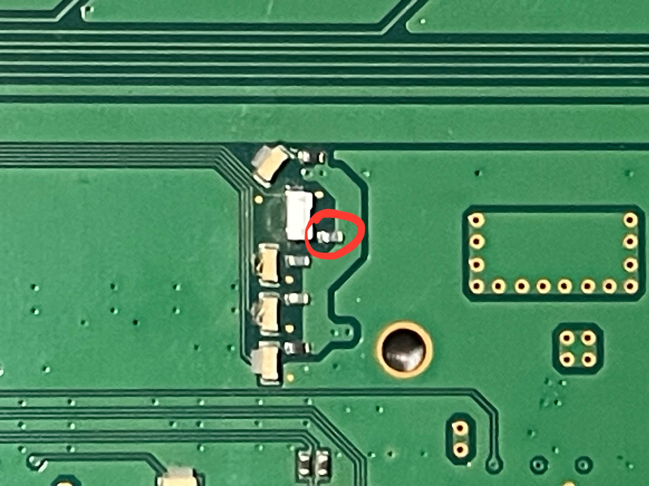

My PS4’s white power LED always remains off even though the console works fine. The white LED looks like its burnt out but I can’t find any suitable replacements and I cannot afford a donor board. Does anybody know any suitable replacements for this LED? I have a board revision SAB-001 (1-893-625-11). Thank you.
Just found out that it is the resistor (I think, it could be something else) that is right next to the LED that is bad, I have attached a photo. Does anyone know the value of this component or a suitable replacement?
The value of this resistor is 100 Ohms. I replaced it with a RC0402FR-07100RL resistor from DigiKey and now it works perfectly.
