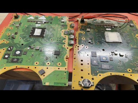

PS5 EDM-033 - history unknown. Arrived dead to the world.
I’ve replaced many chips on this thing; some had visible holes from something happening to this console. Other chips were shorted and glowed under thermal. Big name chips I replaced are the WiFi chip, southbridge, SSD controller, and SDRAM. Various UART codes between major processes. I eventually a beep, no lights, and now get the following codes:

During initial power, my bench PSU reads .220 amps and down to about .005 amps after initial boot sequence.
Any clues what to check out next?
resistance to ground for both 5v 3.3v standby?
Where should I measure for these exactly? Behind the encoder?
