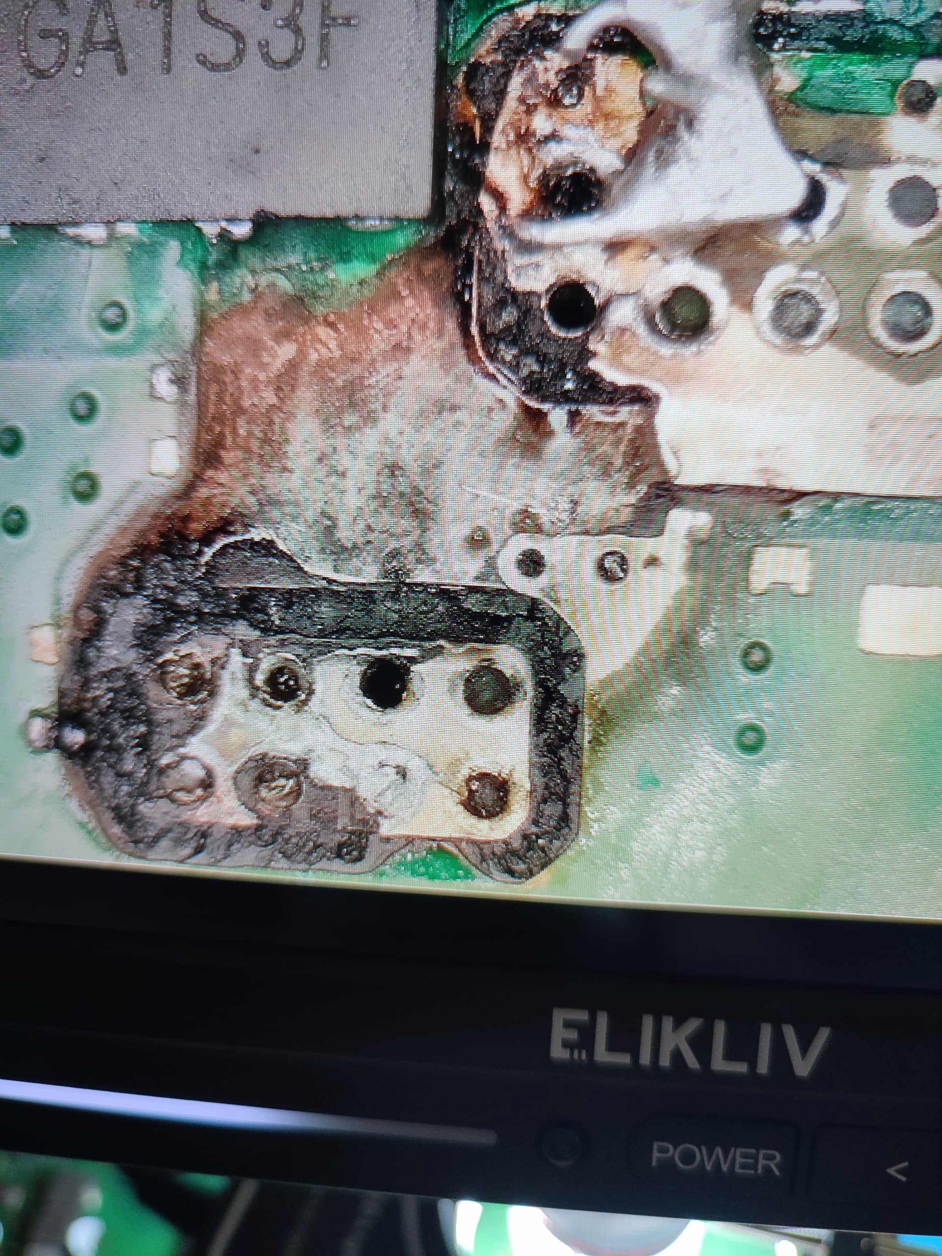

Hello,
From one day to the next, I turned on my ps5 and heard the sound of a firecracker, and it smelled like something burning…
I decided to take it apart to see what had happened, and well, the motherboard took a beating.
One or more components must have exploded.
I’d like your help, please, to know which component to repair, etc…
I’ve started testing the power supply and I’ve got 12V Output, so that’s already good.
THOSE CAPS are on the 12v main line. and you should fix 12v if any short or repair the burn area prior to replace those 22uF caps front and back.

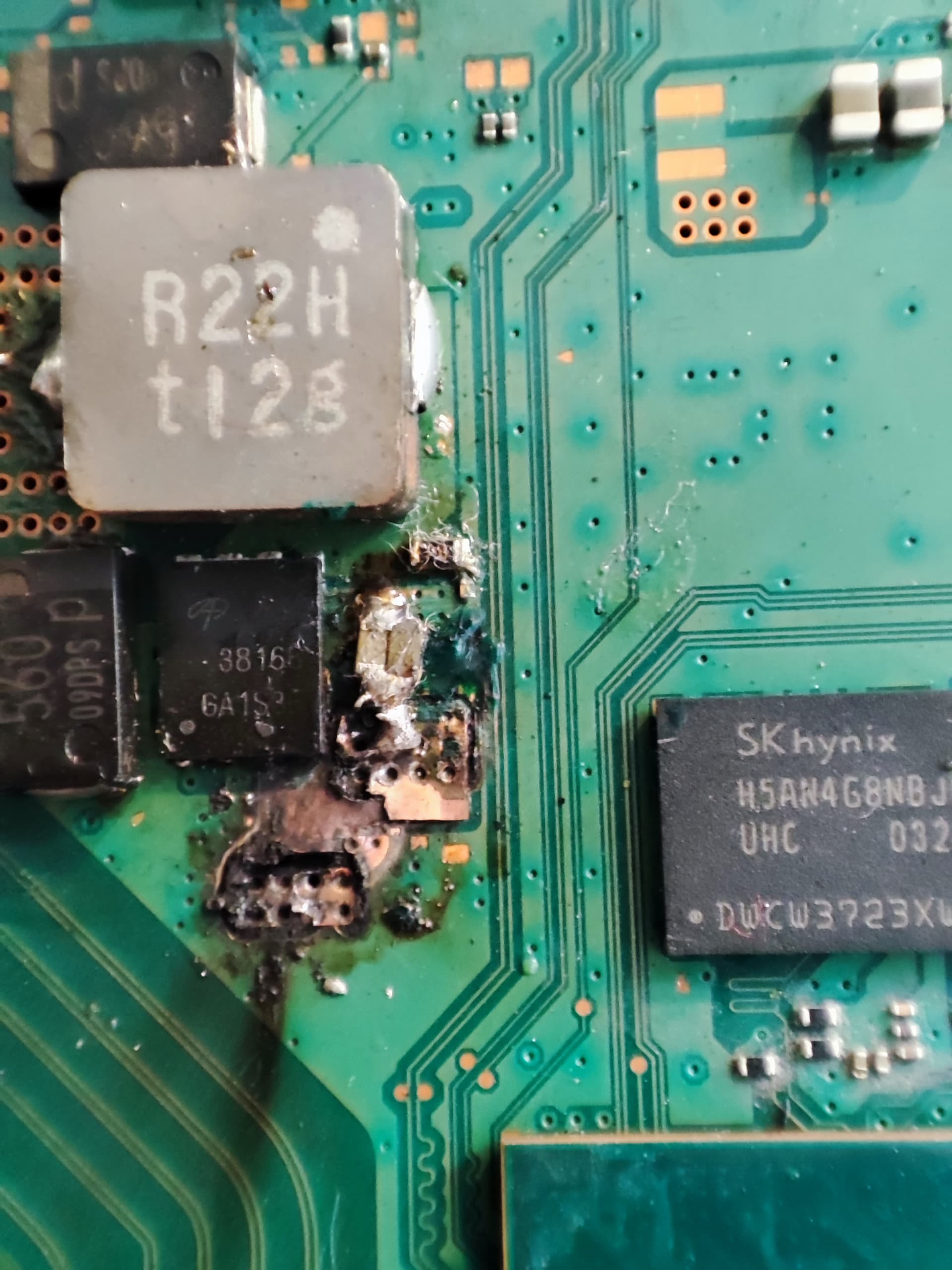

IMG_20240921_112610|375x500
Is that repairable? Looks like there are several layers… what do you think?
