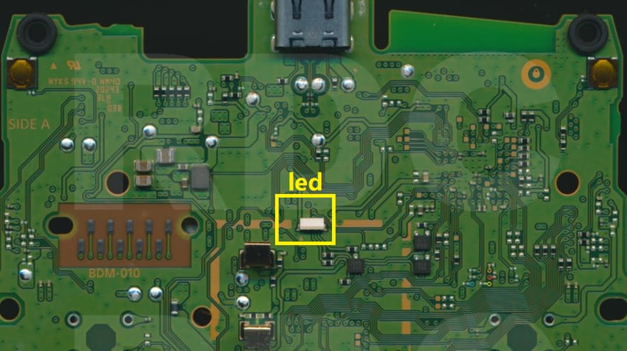

Take the board out and check if anything block or broke the led in the center of side-A (near speaker contact point)
