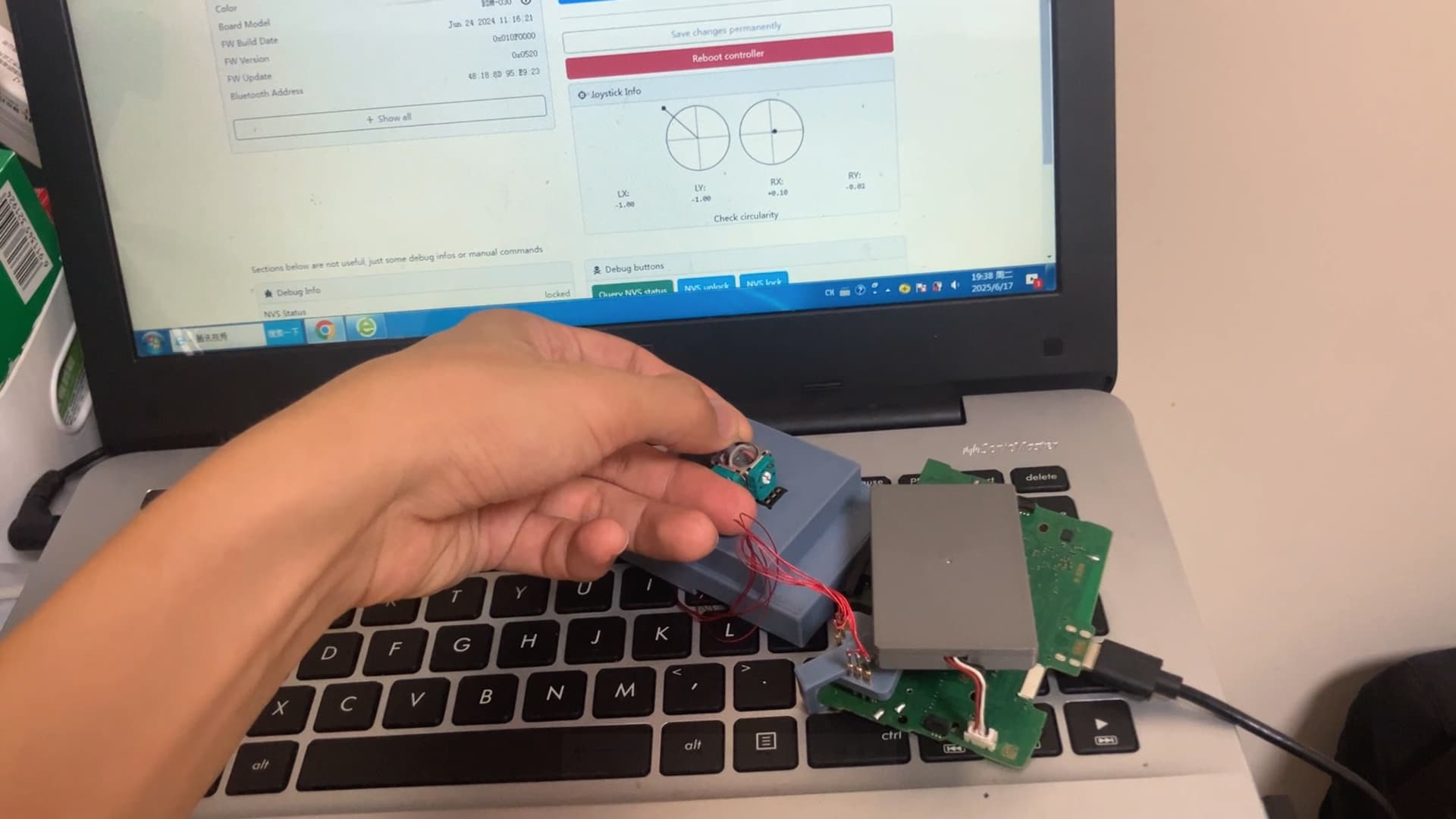

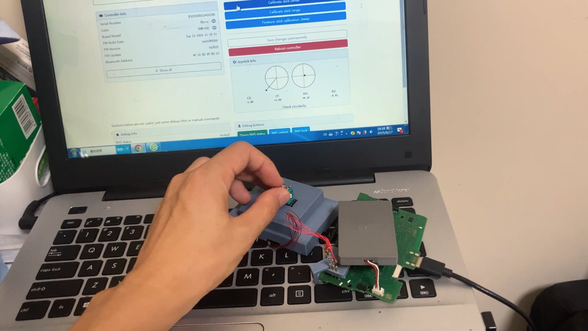

PS5 controller BDM-030 joystick only two direction
the trimmer is positioned incorrectly, remove it from its frame, spin it idle and then re-fix it
This position works fine on the other one. So it may be the pad issue, someone says vcc pin pad may shorted to the GND
