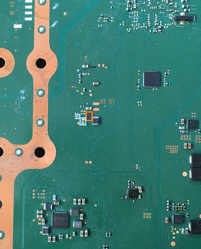

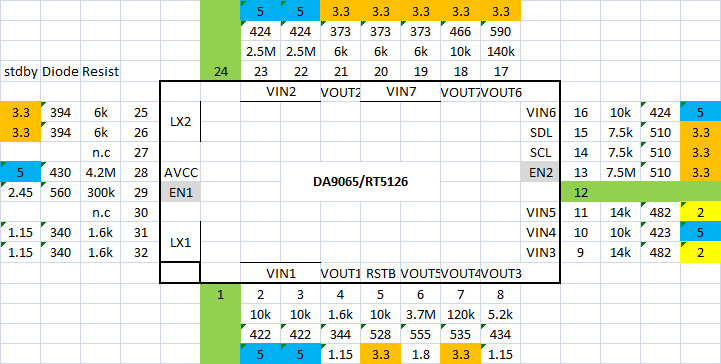

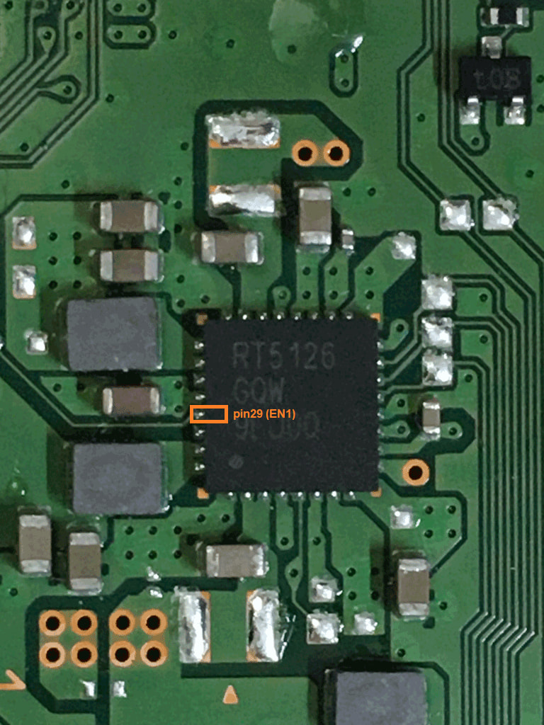

I would check at the SB pmic DA9065/RT5126 at pin 29 (enable 1) if the 1.95V are present.

can you share schematic of SB? where is pin 29?

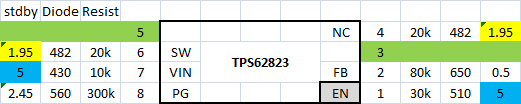

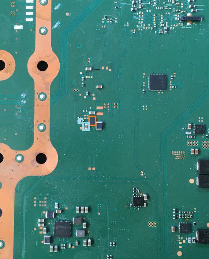

This is a bit to low… it should have 20k Ohm. There is a little bug converter which generates the 1.95V.
The readings should be the same at an edm-020

Pin 8 at the bug converter is the EVER_1.95V_PG signal which is the same line at pin 29 at the DA9065/RT5126. If this line is ok the same should be at pin 29 at the SB pmic.

so i measure again a2 tps62823 pin 8 16 ohm and SB pmic DA9065/RT5126 at pin 29 also 16 ohm.

I would measure the pins of the A2 TPS62823 and SB pmic and compare it to my readings (voltage/resistance/diode mode)
