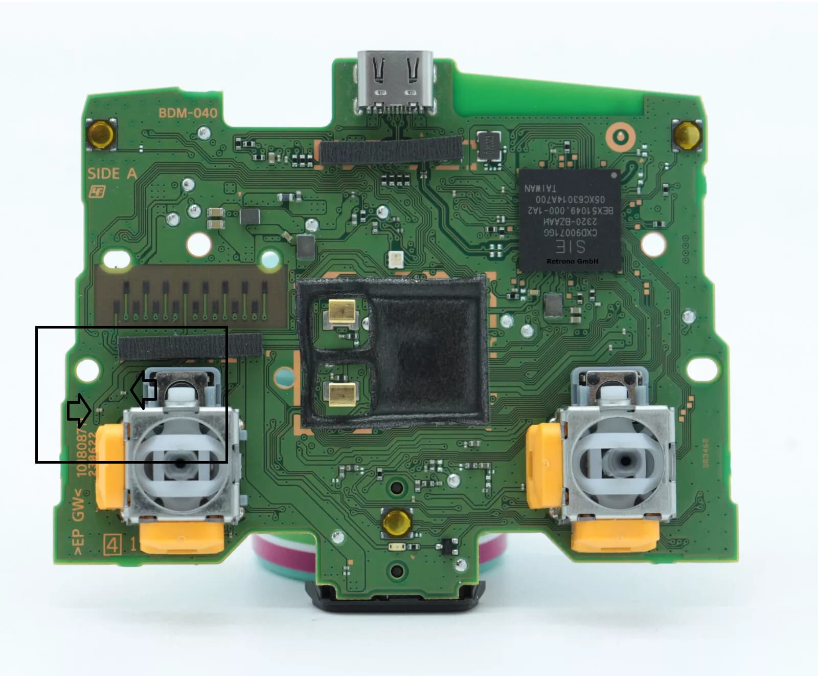

Hi guys,
i made a misstake an lost the both caps. Do anyone know the values?
THanks
red
Hello were you able to find out which ones they were I just had one fall off as well.
0.1uF, 6.3v most likely
I just repaired a BDM-030 today, it had a few of those caps ripped off. I soldered on a bunch of 0.1uF in their place and everything’s working nicely.
